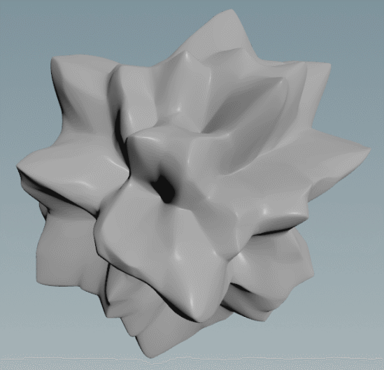

831 posts
Hey Everybody,
here is my take on the subject. I would love to get rid of that final smooth operator. Any ideas are very welcome!
Cheers
CYTE
Sharpen.hiplc (147.8 KB)
CYTE
Hey Everybody,
Cheers
CYTE
Made this account to say, amazing! I've been looking around the internet a bunch for an equivalent to zbrush's “clayPolish” and it looks like you've figured out pretty much exactly what it's doing under the hood – tangent smooth! Thanks so much dude!

I'd go further and say you actually improved Zbrush's ClayPolish tool. And it's also much better than Lab's mesh sharpen. Thanks a lot!!
