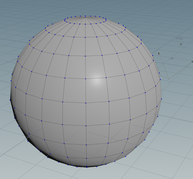

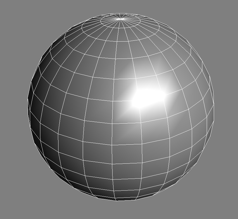

Hello all,
Is there a possibility to work without antialiasing in the Viewport Scene view?
I found it 10 times much easier to work on a mesh than with antialiasing .
I feel a little blurry and don't need that thing.
Difference between with and without is really clear.
Anybody has a solution?
Greetings
Fred
5342 posts
No there's not, because the wire is actually part of the polygon, not a line. However you can increase the visibility of the wire by increasing the Wire Blend display option on the Geometry tab of the display options.

24 posts
Joined: March 2014
You can set the antialiasing to higher value. Plus, as twod answered: change the wire blend to 1 and I did also change the wire width to 1.5
And thats very precise and good at the end
