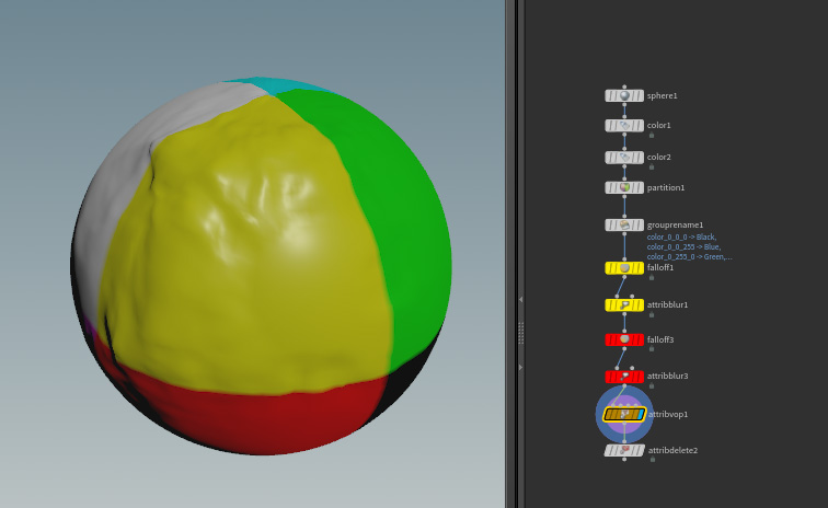

Hi, I've attached a hip showing two examples.
Both methods show how you can use a bounding box's colour for masking noise.
1st method uses RGB applied to the bounding box axis which is then used as masks for the noise.
2nd method uses the Color Sop's bounding box, then partitions the colours for groups and falloffs to use as masks for noise. (I've just shown red and yellow)
Rob
