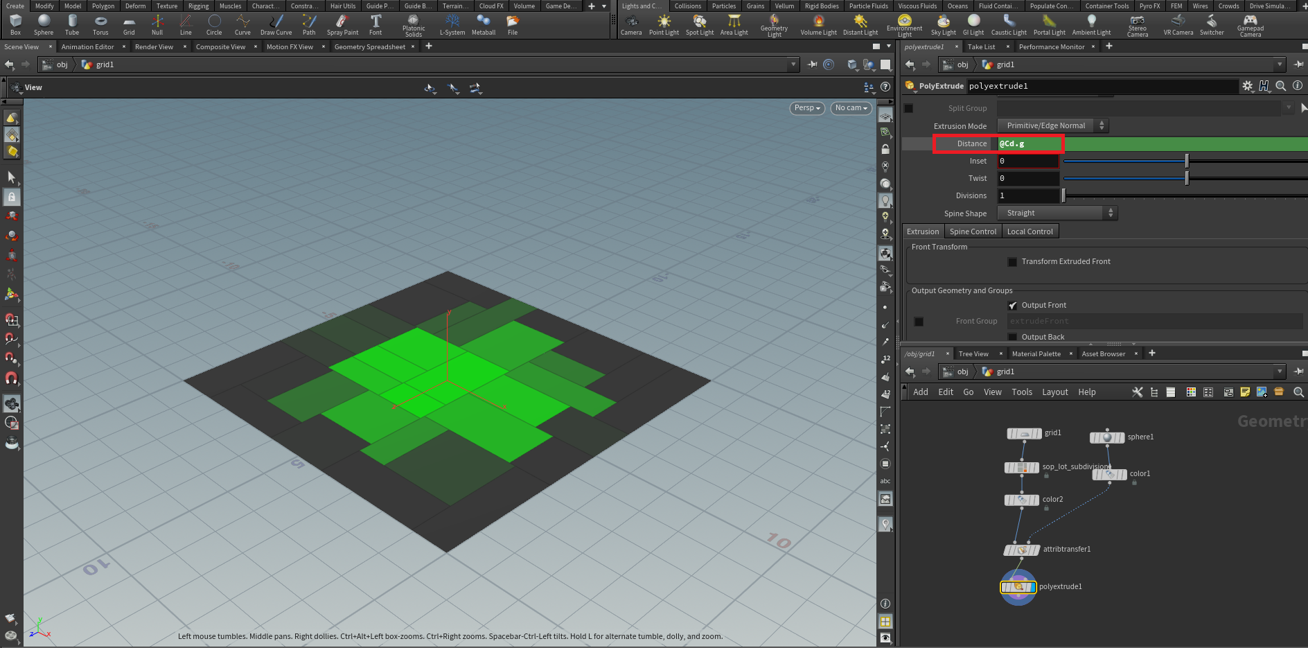

Hi.
I am trying to poly extrude primitives, the extrude distance is set to @Cd.g but its not extruding. I check spreadsheet and the Cd attribute are there, I am not what I'm missing, please help!
504 posts
go to local control tab -> activate the checkbox (distance scale) -> define prim attribute called zscale (or rename it), just use
prim wrangle and set @zscale = @Cd.g;

Still not extruding at all, even tho the attribute values are there.
I have Local Control/Local Attribute/check boxed “Distance Scale/Zscale”.
I run primitive wrangle over primitive after poly extrude with “@zscale = @Cd.g;”, but the extruding is not happening.

put wrangle before extrude

Hi, I've attached a hip file and screenshot showing some options.
1st and 2nd methods move the wrangle above the extrude.
1st and 3rd methods use Individual components on the extrude. (and a Boolean to clean up)
2nd method uses a soft peak.
3rd method uses distance from geometry.
Rob
PolyExtrude_RS.hipnc (150.5 KB)

Thank you all so much, I figured it out now with all the example you all given me, thanks.
