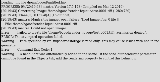

Hello ,
I managed to make a farm between my two linux machines, now I can start a job on the farm but I have another problem after two seconds my job fails.
I don't understand why?
A shared folder problem?
Please help i dont understand

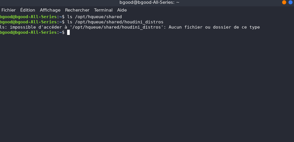

I have this message “ /bin/bash: ligne 0 : cd: /opt/hqueue/shared/houdini_distros/hfs.linux-x86_64: Aucun fichier ou dossier de ce type
I think is a shared folder problem ?

Do you have a houdini distribution installed in /opt/hqueue/shared/houdini_distros/hfs.linux-x86_64 ?
I'm assuming you have /opt/hqueue/shared as your hqserver.sharedNetwork.path.linux in hqserver.ini.
I typically install houdini into the shared directory /opt/hqueue/shared/houdini_distros, then symbolic link to the one I want to be used by default.
So assuming you've installed the latest distro into /opt/hqueue/shared/houdini_distros/hfs17.5.425
> cd /opt/hqueue/shared/houdini_distros
> ln -sf hfs17.5.425 hfs.linux-x86_64
-Drew
-Drew

These things happen …
1. The Hqueue server is installed somewhere, either windows or linux. The server does not need to mount the shared filesystem.
2. The Hqueue clients are installed on the machines you want doing the work, windows and/or linux. The clients _must_ all be able to see the shared filesystem. Note: this means if want your server machine to also do work, you'll need a Hqueue client installed on it as well and hence the shared network mount to be present. I'm guessing from what you've desrcribed this is what you'll be doing.
3. A full Houdini distro must be installed on all the clients machines, and the easiest way to do this is to install it once onto the shared filesystem that is accessible to all. ie into /opt/hqueue/shared/houdini_distros/ directory like I detailed above.
You may also eventually need a Windows distro installed on that shared mount as well, but I'm not a Windows user so others will need to jump in here for the detalis. While you're getting things set up I'd just have linux be the client. One you get that running proprely you can think about adding Windows as a client as well.
Hopefully this is a bit clearer. BTW I don't recommend going to H18 yet.
-D
-D

So i suggest you
> mkdir /opt/hqueue/shared/houdini_distros
Then install a full distro of linux houdini into this, ie something like the following
> tar xvfz houdini-17.5.360-linux_x86_64_gcc6.3.tar.gz
> cd houdini-17.5.360-linux_x86_64_gcc6.3
> . houdini.install # note the space after the period here
You shouldn't need to be the root user to do this.
… then from the menus you're going to select option D and change the installation directory to be something like /opt/hqueue/shared/houdini_distros/hfs17.5.360 at which point go ahead and install.
Now
> ln -sf hfs17.5.360 hfs.linux-x86_64
Then you should be on your way.
Now

I have some news but it's always the same I'm moving forward a little bit another problem happens I'm going to go crazy. I have a feeling it's a permission issue. If I disable generate ifds I feel it's better but it doesn't make my image.
Sorry for my english but i learn too ^^
