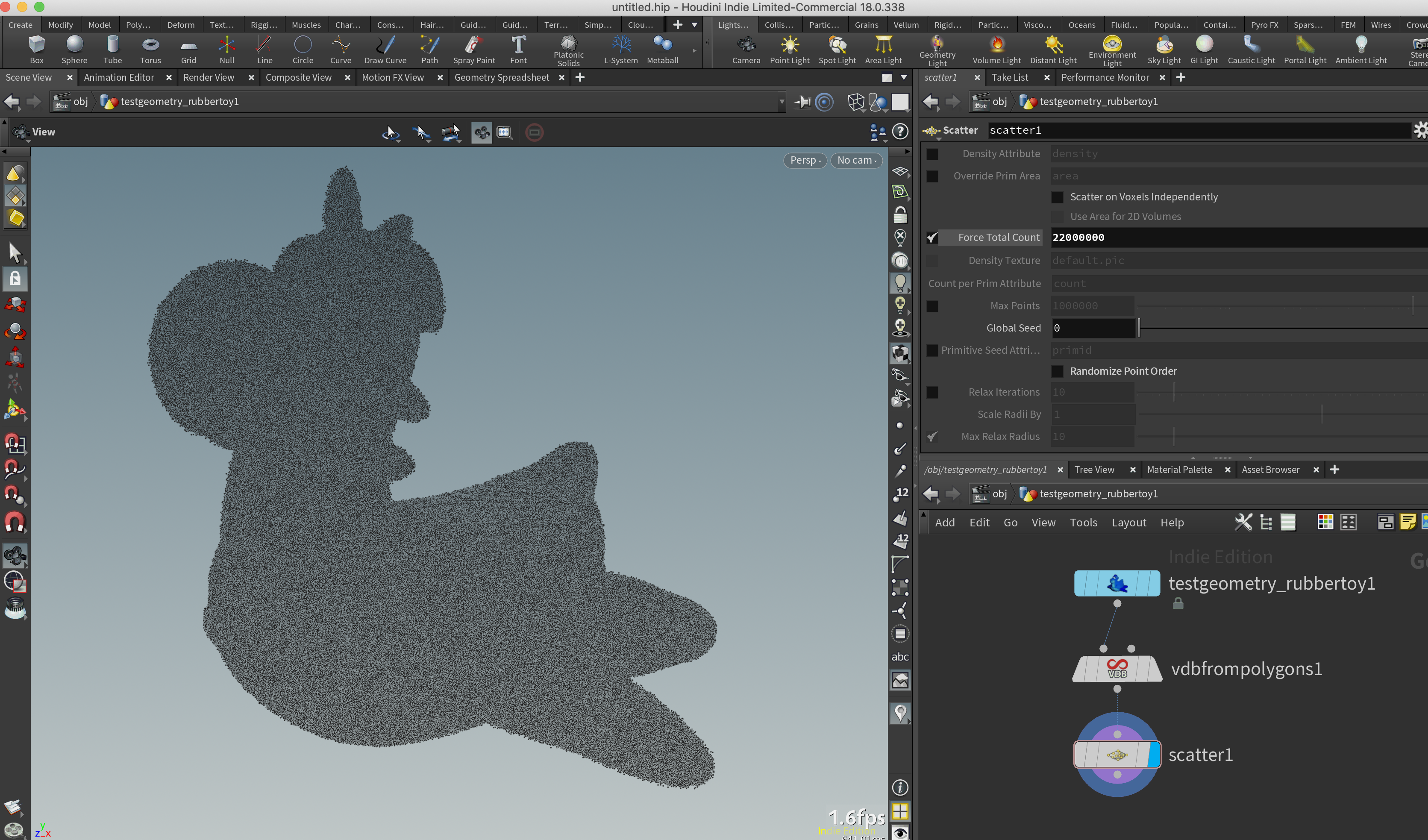

Hi, I currently have a 15" MBP 2017 that is way to slow in the viewport and wonder if it is worth upgrading to the MBP 16 for this reason? Right now looking at a 22 M point cloud that updates at about 250 ms (about 4 fps).
Any experiences and conclusions now that there has been some new point releases both to catalina and houdini? (a windows or linux laptop is not an alternative)
/Filip

For reference, a 1060ti in a Windows laptop gets 16fps for your test. Unfortunately, as mentioned many times, if the hardware isn't supported by SideFx you will be at the mercy of running an unsupported system that will exhibit problems.
Edit: as a test. please boot your MacBook into Windows and test Houdini. In theory, you should see remarkable gains in performance. This will then confirm that it is a MacOs driver issue.
