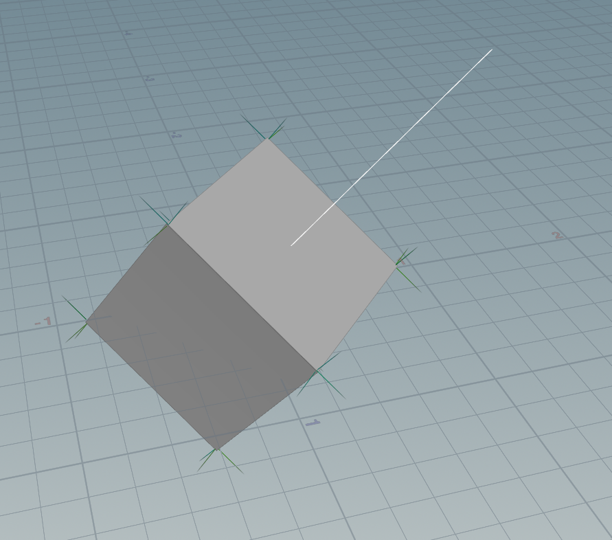

You can see in my example images I have done this. The problem is that the copy to points node doesn't know how the box should be rotated around the axis. To fix this you can also provide an ‘up’ vector attribute so that the copy to points node can resolve this.
In my first example, the up vector is set to {0, 0, 1}.
In the second it is set to {0, 1, 0}.
Edit: the vectors were in the wrong order for the images. First is with {0, 0, 1}, second with {0, 1, 0}.
You can see that although both are oriented along the normal, they are rotated differently about this normal.
