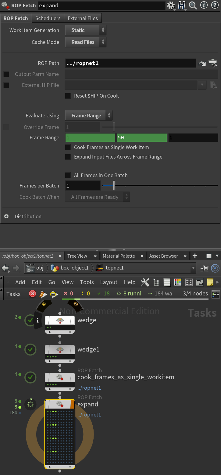

In ROP Fetch, there is a option named
If I turn off this option,render time become super slow
it takes 19min for 200images with simple simulation.
but if turn on this option, it take only 13 seconds
The result is totaly same with 200 images but duration is too different.
I don't understand why there is a huge difference.
there is the hip file below this post
thank you!

That option causes all the work to be done in one ‘batch’. This is usually a good option to use if the individual frames are fairly quick to cook because it eliminates the overhead of starting Houdini for each frame.

By the way, is there a way to get work items from exist files?
is so fast for render, so I thought
use this option first on first rop fetch node
and on second rop fetch node, change cache mode to
then I could get file already rendered to work items.
but when I did it, second node didn't get images but rendered same things again.
The reason that why I am trying this method, I want to use ffmpeg node after render.
but if I use option , I can't make video.
so I have to expand to seperated work items.
images are represents first and second node
sorry for my bad english
thank you
이미지 20200211_006.png (155.5 KB)
이미지 20200211_005.png (165.7 KB)
407 posts
Joined: Aug. 2017
Enable the “All Frames in One Batch” option instead of the “Cook Frames as Single Work Item” option. (You will only need the first ROP Fetch when using this method).
Joined: June 2017
BrandonA
thank you!
but that option doesn't work on rop fetch properly.
I used ropmantra node instead and it worked well
