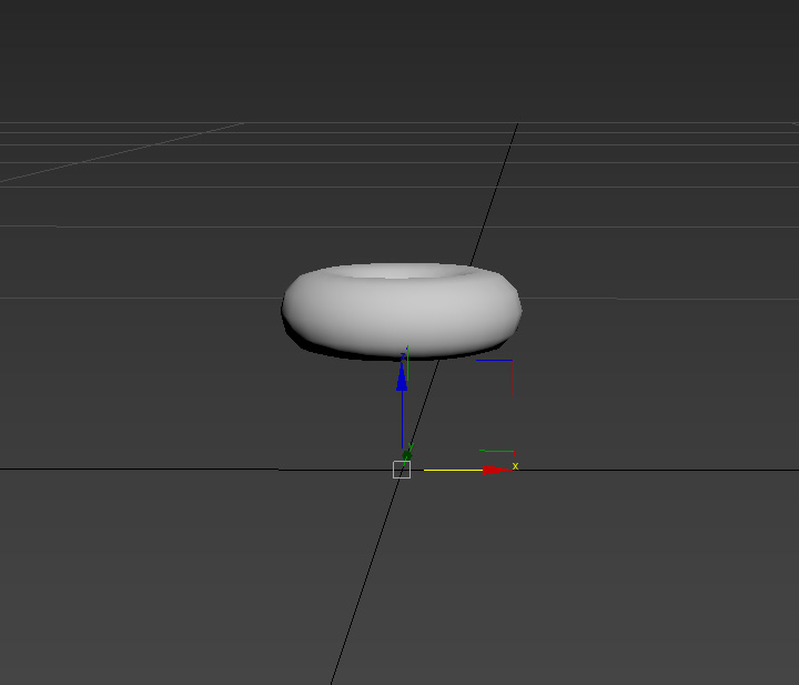

22 posts
Joined: June 2017
Here are some sample pics. I think this makes it clearer.
555 posts
here's a torus example
obj works as per @tamte's instructions but you'll note that in Max, the pivot is still at Origin, you'll have to:
- affect pivot only
- centre to object
- Reset Xform
- collapse
vu_torus.hiplc (63.7 KB)
