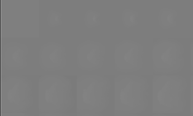

So I tried that, and it kind of illustrated the core issue even more. I set the frame range to 1-36, set the images per line to 6, and the result was the attached image. It didn't properly set the vertical height at all and still filled the frame with 64 images, with the last 36 just the same image repeated. Possibly this ROP node is just broken? It also continues to have the same issue of a Green channel with good values, and a red channel with nearly no information.
