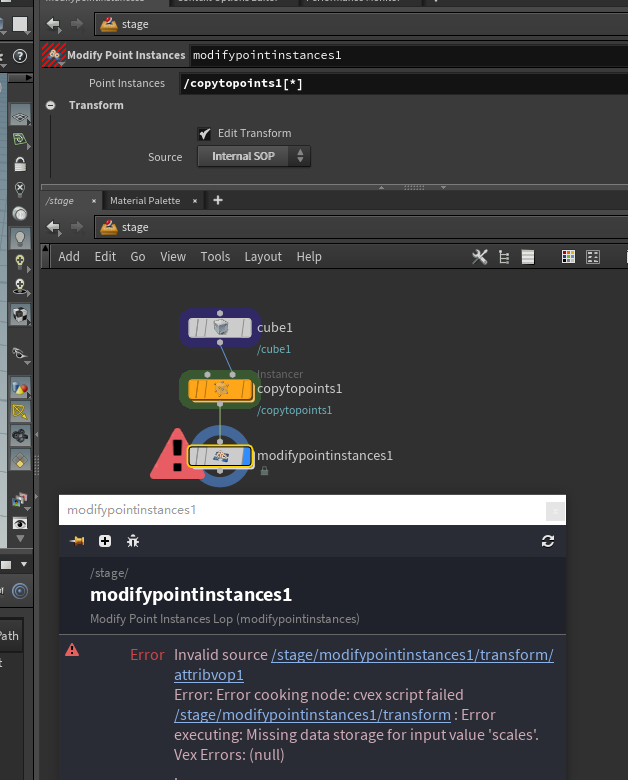

It seemed some problem with modify point instance lop.
instance.hip (114.5 KB)

I've also found this node to be quite buggy, so I had to write a custom node that just applies all parameters of the points to the PointInstancer parameters in a python script node.
Also using this modifypointinstances node with setting the Point Instances parameter to "/points" will create a huge json array of every point internally, which will overflow the python scripts when having a huge amount of instances (> 10.000).
