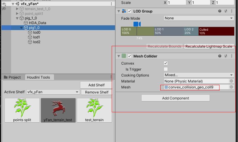

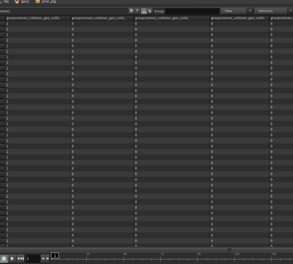

I wanted to make Mesh Collider out of multiple convex objects, and they only made Mesh Collider out of the last convex body.Did I do it wrong, or was there some other way?
Attached pictures and HDA
Thank you for your help.

Only 1 Mesh Collider is supported at this time. You can submit a RFE to our support to add this as a feature.
