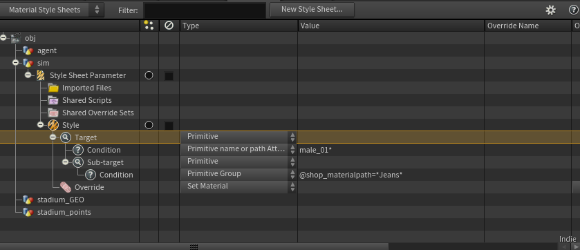

Well, by random stabs in the dark, I have found that this works, but I can't tell you why it works.
Such is often the way with Houdini…
Thanks for your help!

808 posts
Joined: Oct. 2012
That looks correct - the primitives you're trying to target are in the third level of the hierarchy (agent prim, shape, then polygons)

My confusion come from (among other things) having used this Style Sheet thingy before when the Agent has Agent Shapes.
Now my Agent does not have Agent Shapes, so I have to dig down into the one shape I do have and pick out the Primitive Group.
Does that sound right?
808 posts
Joined: Oct. 2012
That sounds right, but it really depends on your source asset and whether its geometry was split up into multiple geometry nodes or not
