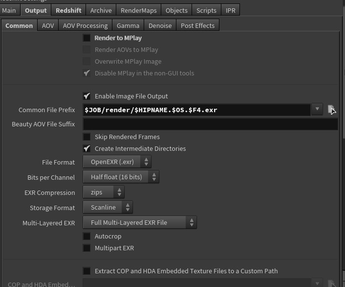

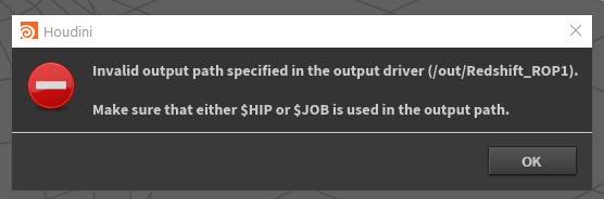

I am trying to submit a very simple Redshift scene to HQueue, but no matter what I type in the output patch I get the same error:
Invalid output path specified in output driver (/out/Redshift_ROP1)
Make sure that either $HIP or $JOB is used in the output path.
I am using $HIP or $JOB just for testing but I want also to be able to specify a custom path anywhere in my network, since I have a NAS I am rendering to.

I was pointed to a workaround on the Redshift forum:
If somebody else stumbles upon this post to fix it you have to open it's python definition in hqrop.py and add the following lines after the if at line 98:
    elif rop_type == 'Redshift_ROP':
        output_parm = rop_node.parm('RS_outputFileNamePrefix')
It did solve the "Invalid output path" error, but now I'm getting an error related to some utf-8 byte which cannot be decoded...
