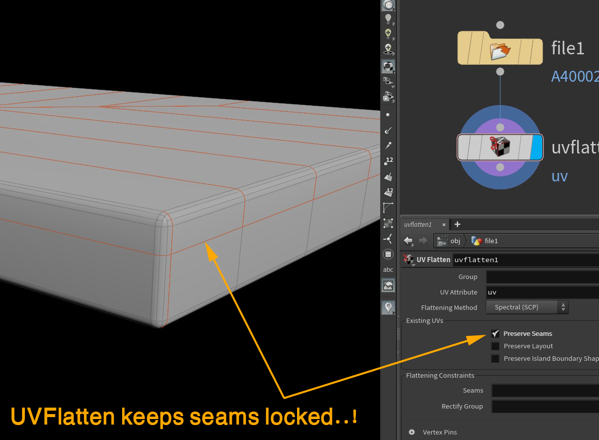

Hello;
I would like to use the existing UV of my imported geometry as a starting point of UV mapping, So I tried UVFlatten SOP. The problem is by selecting “Preserve Seams”, it locks existing UV seams and I can't sew them.
How can I fix it?
Thanks for helping.
Masoud Saadatmand (MSDVFX)
21 posts
Joined: Nov. 2013
You probably want to check this video, Fianna explains how to do it very well: https://vimeo.com/257188140 [vimeo.com]
