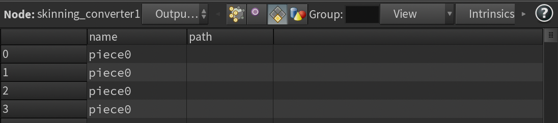

Joined: July 2014
In my case the path attribute per prim was empty due to the Skinning Converter node, used somewhere before in the setup. Added an Attribute Delete node in order to remove the path attribute and it works fine now.
