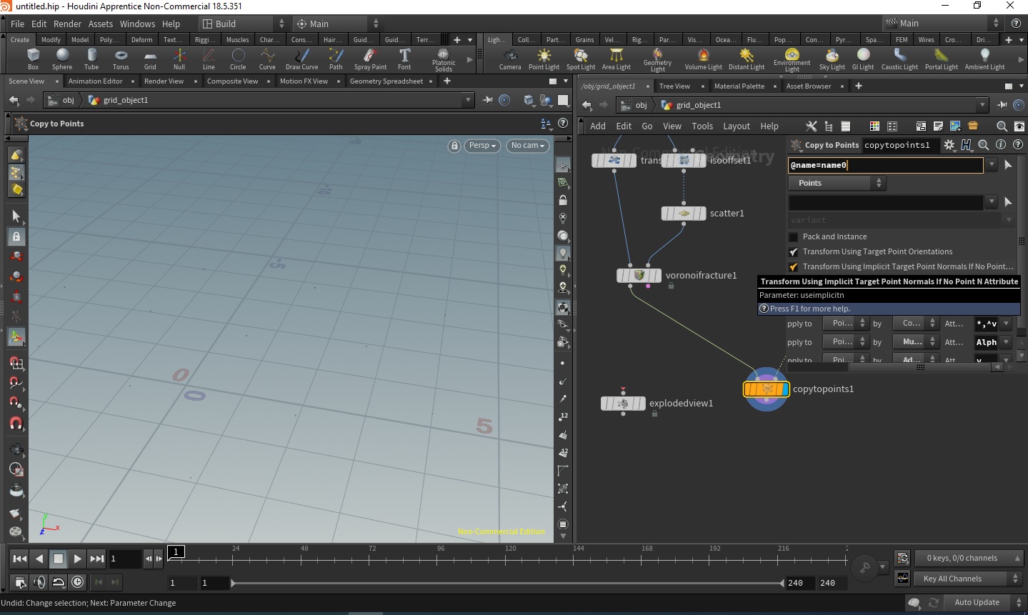

I have a noob question about copy different geometries to a point without using VEX (I just have 2 weeks of learning and I'm not
ready for VEX yet).
I'm trying to model a river cliff with some uniform rocks using voronoi fracture and transform pieces. However, every single time I made this, the whole fractured model goes to the scattered template.
Need some help, because I can't find anything on youtube
Thanks!

Hey Paulo,
You need two additional things:
First, you need to pack your fragments. Use “name” in the name attribute field. “name” is the attribute that the Voronoi fracture creates for you for each piece. Then you have to give the points that you copy the fragments to the same “name” attribute so Houdini can match it. I kept this a little bit vague so you have to dig a little bit by yourself (Unfortunately the only way to really learn something, I´m learning UE Blueprints atm. I know how you feel

First, thanks to answer!!
I realize the pieces name changed to @name prefix, but the last thing to do I didn't get well.
The first thing I thought is to randomize those groups to get the result, but I'm not sure if it is work.
It's like you know what to do, but don't know how hahahha
Also, I could see that all geo disappear from points when I choose one of the group “name”
