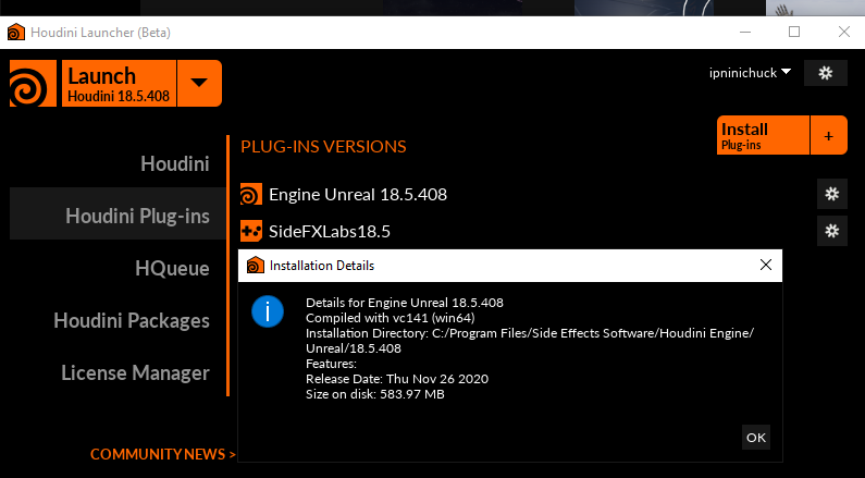

Hello,
I am using the new launcher SideFx has in beta for managing Houdini. I installed the UE4 plugin but I am not seeing it as a plugin that I am able to enable in UE4. I might be a little rusty on setting up. I am attaching a screenshot with the launcher/plugin information.
Okay, after spending some time reading through similar problems faced, and finally having a lightbulb moment, I figured out that you do indeed have to copy the plugin files manually from Houdini Folders, to the UE4 installation. I was under the assumption that installing the plugins meant it was installing them to the UE4 Engine. My mistake…
Edited by ipninichuck - Dec. 8, 2020 01:39:45
Screenshot (457).png (49.3 KB)
564 posts
Joined: Sept. 2016
That is correct, since H18.5 offers both Version1 and Version2 of the plug-in, we don't automatically copy the plugins files to unreal automatically.
It's up to you to copy the HoudiniEngine folder of your choice from Houdini's “engine/unreal/4.XX” to Unreal's “Engine/Plugins/Runtime” folder.
