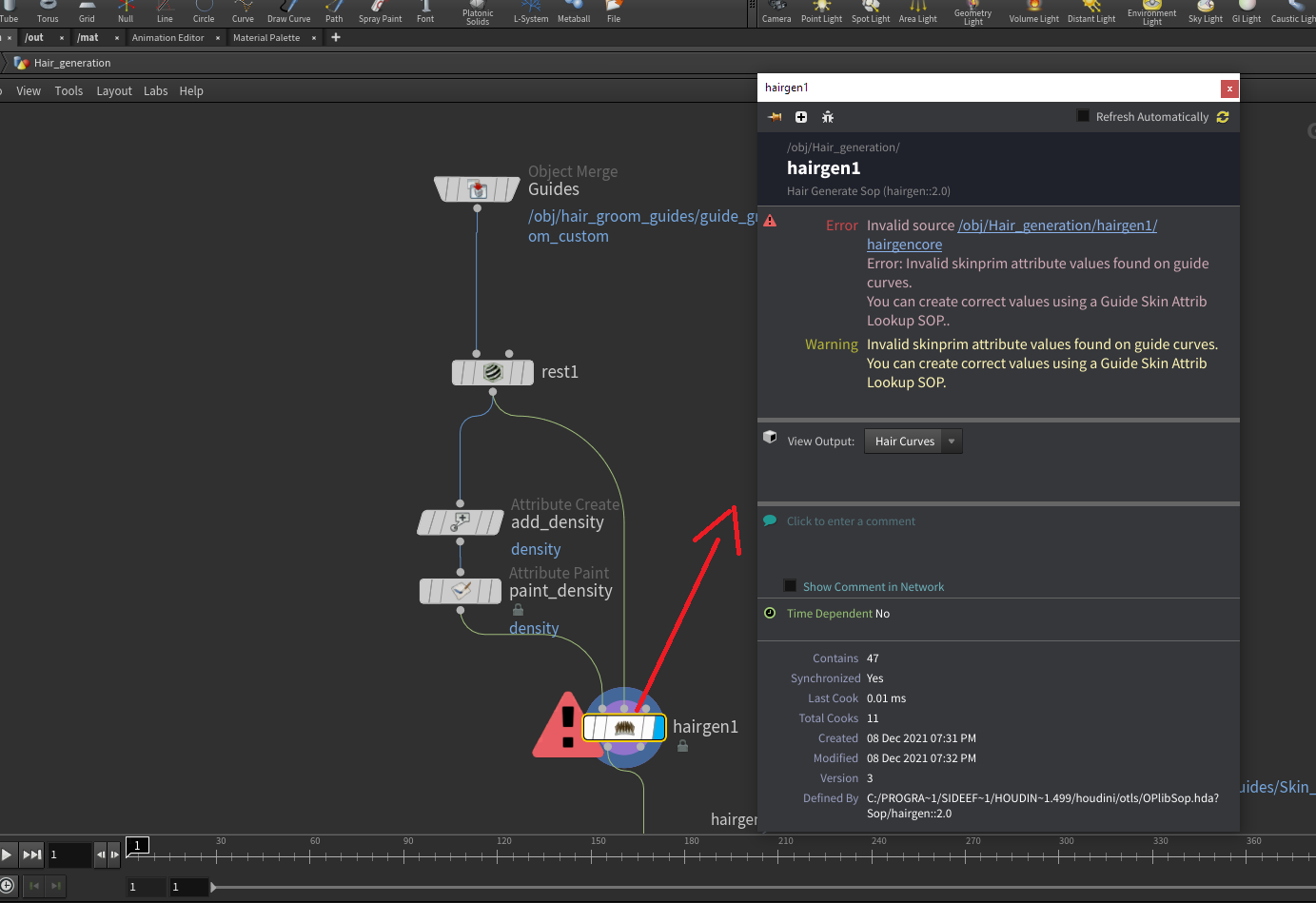

Hello @BrianHanke,
I've used your hair config a few times without any problems, but I'm facing something that I can't manage to resolve, maybe you could help me !
I've imported an fbx as my face object, and the whole guide creation process is working well, but I have an error on the hairgen node, inside the Hair_generation, that despite all of my debugs, I can't resolve.
Invalid source /obj/Hair_generation/hairgen1/hairgencore
Error: Invalid skinprim attribute values found on guide curves.
While in the same project, if I replace my fbx object with any other geo, it works like a charm !
Maybe you have any clue ?
Thanks in advance
Edited by frBorges34 - Dec. 8, 2021 14:45:35
461 posts
Looks like you need to merge your skin and connect that to the left input on hairgen1. Right now you have your guides connected there.
Yes, thks for your answer, that was the point of my edit, it wasn't properly wired !
