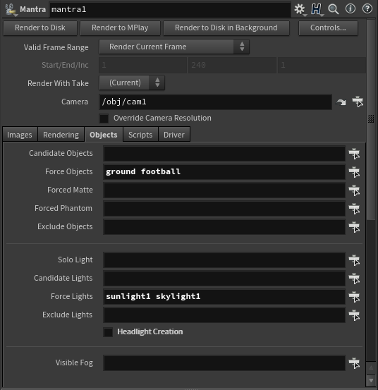

It's not different than any other object. Turn off the display flag, and add it to force render objects for render. Only rendering the forced object list is the most common render strategy for Houdini.
Did you actually try that ?
Because that’s my thought as well, and peeps keep pointing that out to me, but no matter what I do, I can’t seem to hide the HairGen from display only and still render it. Not with the "Togglehairdisplay", neither by adding a Null inside the HairGen SOP and toggling the display visibility by having the Null taking care of that.
This works with any other plain vanilla object, but not with the HairGen it seems. As soon as I exit the HairGen SOP, the hair is visible again.
Yes, it works as described.

Completely hiding the HairGen from display and render as you show in your video works fine here as well. That's not the issue.
But what I mean is to hide the HairGen from display only, so that it still renders by disabling just the display flag in the HairGen SOP and enabling it on the Null.
When I do that, as soon as I exit the HairGen SOP, the hair is visible again.
Of course, because the display flag inside the hairgen doesn't mean anything. The output node is used to send to the rest of the hairgen nodes. You'll see if you go to the level between the editable subnet and the object level that the hairgen has quite a bit more work to do after the groom nodes. If moving the flag had any effect then the node wouldn't work at all.
Use the object level flags to control visibility. Sop level flags are not for controlling visibility in the viewport/render. They are for determining the end point of a geometry network. The separate render/display flags are for setting different end points for render and interactive display. Output nodes always takes precedence over flags.
Hey thanks.
Brilliant, so like I said, the display toggle doesn't work. Because of the magical logic of Houdini I guess.
But I suppose the question still stands, how does one hide the HairGen only from display and not from the render ?
Cheers,
R.
I'm not sure how this question isn't answered. Use the Object level flags. The SOP flags are not used for this.

There hasn't been separate display and render flags in almost 20 years.
Don't use flags to set what is shown in the render. The force object list configures the renderable objects regardless of flags. This is the way to control and objects render/display visibility independently.
Hey thanks.
Well, there is a display toggle in the Geo SOP to hide an object only from the viewport. In fact there's 2 ways to do that.
Why it's not a HairGen SOP beats me, since you can easily workaround that by hacking the SOP. So I suppose it wouldn't be hard to add a simple toggle to the parameters.
