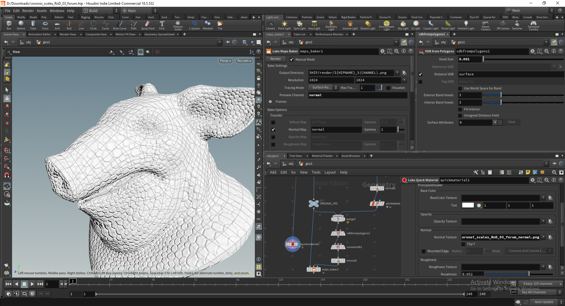

JikianHey thanks for tip, I tried using the baker but just not working out for me, think I'm doing something wrong. I've attached a demo file
If you have used geometry displacement, you can use Labs Maps Baker to bake the displacement from high-res to lower res as a texture.

I modified your setup to utilize Labs Maps Baker.
Merged highres geometry with original then VDB for solidified geometry - Maps Baker doesn't seem to like having topology holes when baking normal maps.
Added normals after converting VDB back to polygons, baked to a normal map and reapplied on original geometry with Labs Quick Material. You can also bake out other maps, but I used normal since I think it shows better visually.
I haven't used Substance but you should be able to bring these maps in for further processing.
