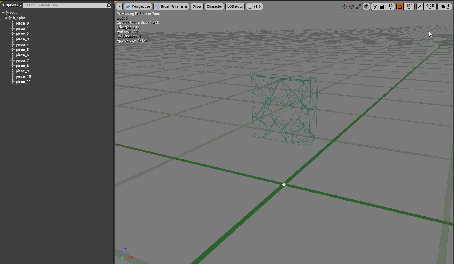

I've added new version of scene. Still have problem with importing this skeleton to unreal.
Bone position are a little bit wrong. Normals too.
