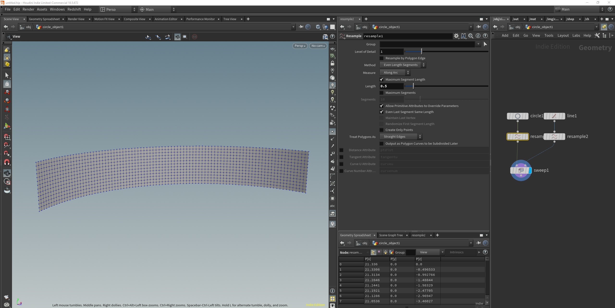

I am no modeling expert but i think if you simply use a resample before a sweep
you can have a surface like this with equal sized square from quad:
