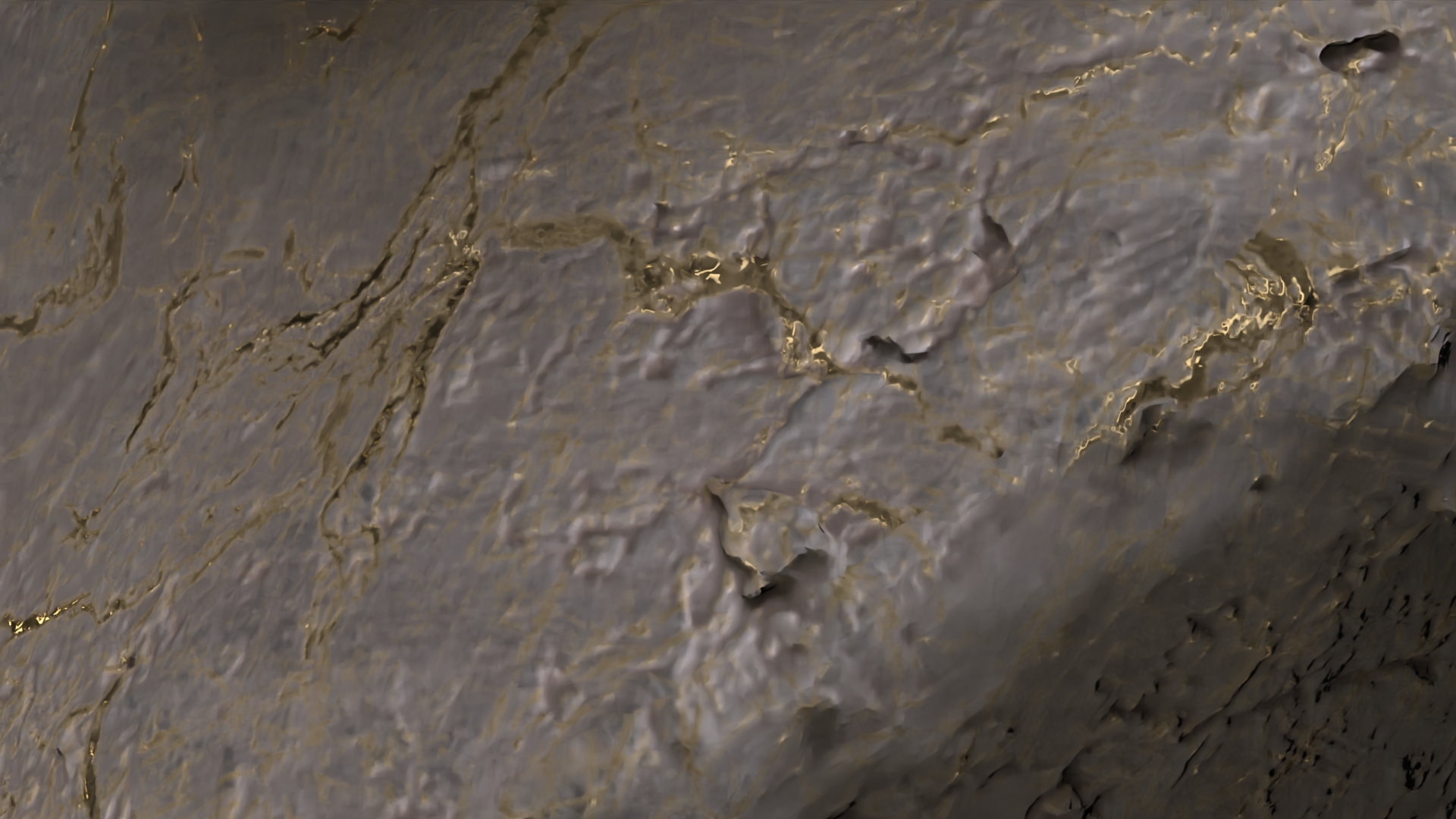

Just testing out Karama XPU and I noticed the texture resolution of my renders seem much lower with XPU vs CPU render. I'm wondering if there is a texture resolution limit settings somewhere or if this is hard coded as part of the alpha?
See CPU and XPU render comparison attached.

There's a limit of 2K per default at the moment.
To go further, set the env variable KARMA_XPU_MAX_TEXTURE_RES, for example:
export KARMA_XPU_MAX_TEXTURE_RES="8192"
for 8K max.
Careful: The memory management right now is a bit experimental. Use very carefully.

Thank you! That did indeed work, I'll keep an eye on memory but I noticed it took a while to load with this env var set
