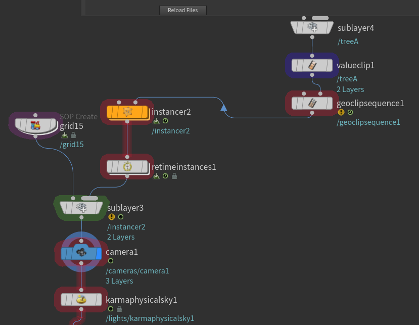

@mtucker i made it loop using 'value clip' but instancer is not take the loop.
file attached .

After you make loop in value clip, go with geo clip sequence - it should work.
