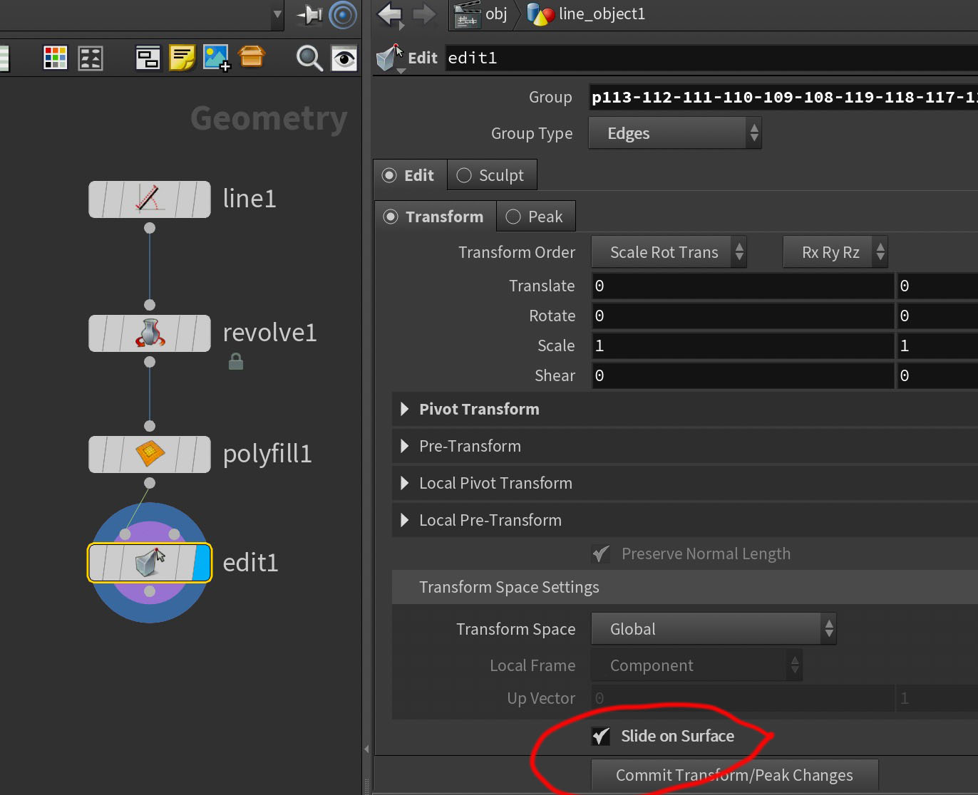

340 posts
Joined: June 2017
When you select points or edges and then click the move tool, it will create an edit node. One of the options on parameters is "slide on surface".
Edited by anon_user_38315714 - Dec. 31, 2021 17:41:58
88 posts
Joined: Feb. 2021
ah yes i looked over the settings in the vieuwport top bar.
19 posts
Joined: Feb. 2019
Thanks so much all of you guys for your help! finally! works!
