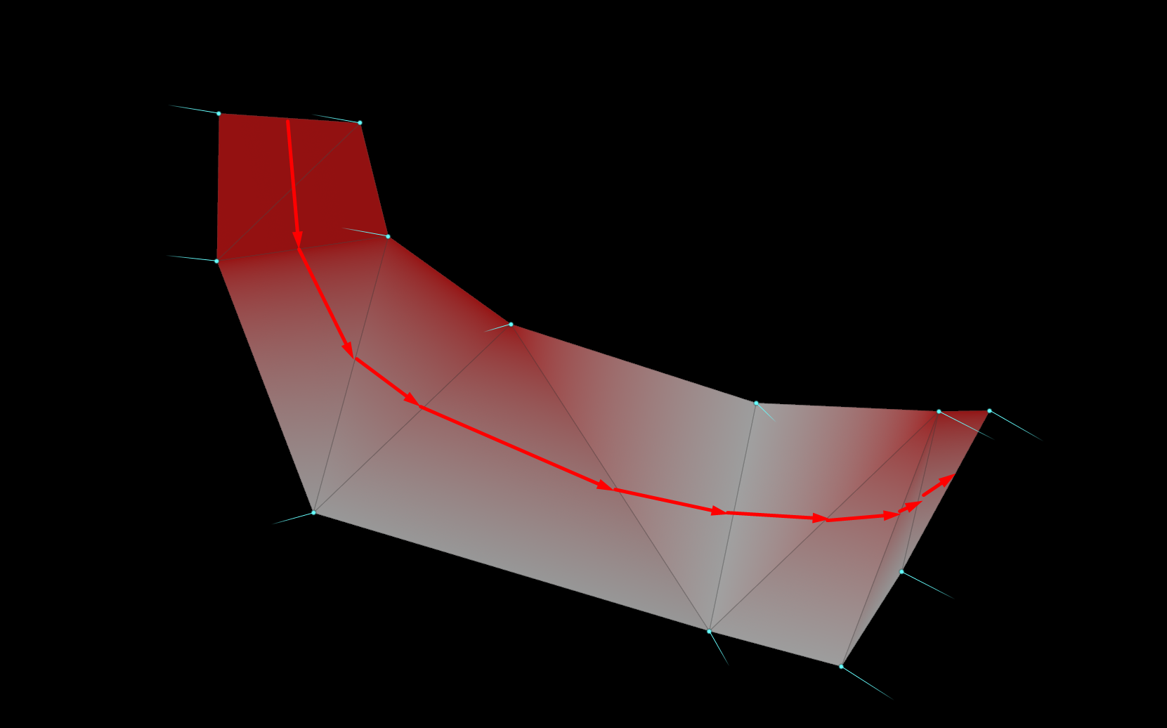

In the image you can see one of the worst case scenarios. The hair strand is f'd up to the max! It's triangulated, points are out of order, no uv, and the normals are out of whack. How in the world am I supposed to create a new strand/curve from that?
The goal is to either reconstruct the card to quads, set proper point order, and uv's map it to 0-1. Ideally I'd like to make a curve our of the mesh for good measure and future control.

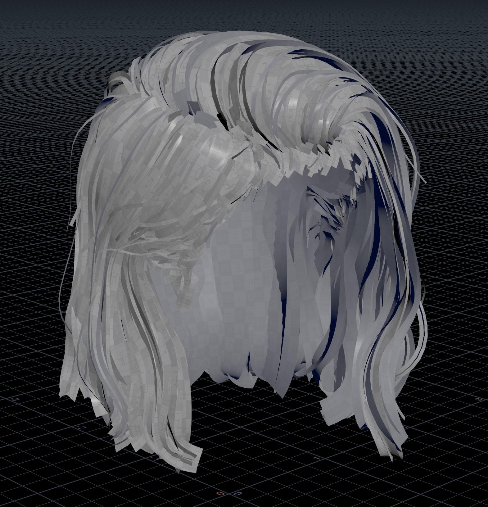

Sorry to bring this topic out but I have been given a alembic file which has come from Maya using the hair cards method.
I am trying to get splines for each hair card and I am not having any luck with any of the setups provided above.
Any idea on how I can get a spline for each polygon hair strip?

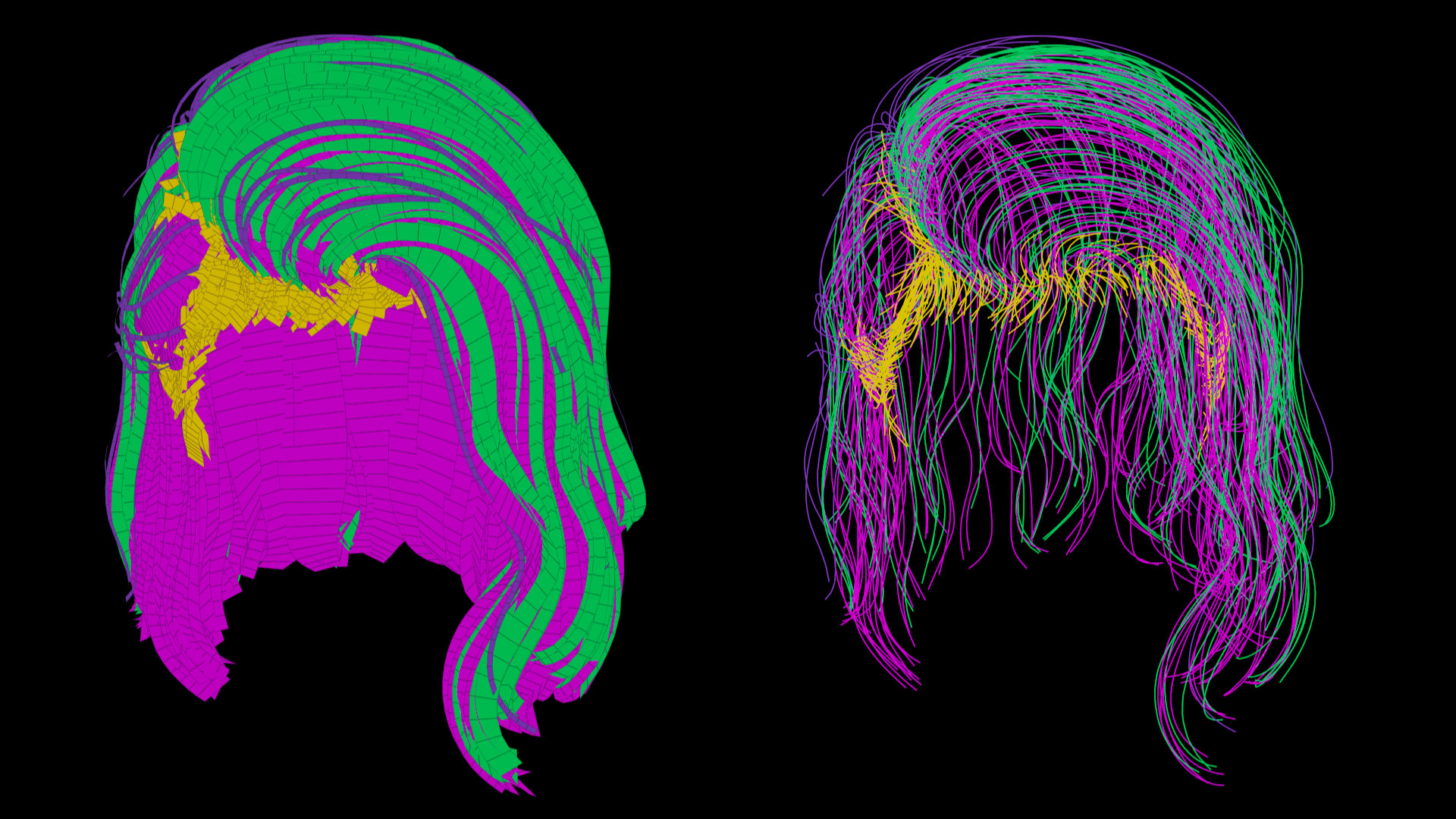

Hi Vivimagic,
you could make use of the hair cards' texture coordinates.
To project curves along the center of polystrips, maximize their UV islands and sample their world space positions to a new set of curves. Optionally, also transfer the path information from the first primitive found within each class.
// vertex wrangle string geo_uv = geounwrap(0, 'uv'); int class = prim(0, 'class', i@primnum); string grp = '@class==' + itoa(class); vector bb = relbbox(geo_uv, grp, v@uv); v@uv = bb;
// point wrangle // PARAMETERIZATION float u = vertexcurveparam(0, i@vtxnum); vector uvw = set(0.5, u, 0.0); // POSITION string grp = '@class==' + itoa(i@primnum); vector pos = uvsample(1, grp, 'P', 'uv', uvw); // PATH int pr = findattribval(1, 'prim', 'class', i@primnum, 0); string path = prim(1, 'path', pr); // ATTRIBUTES v@P = pos; s@path = path;
