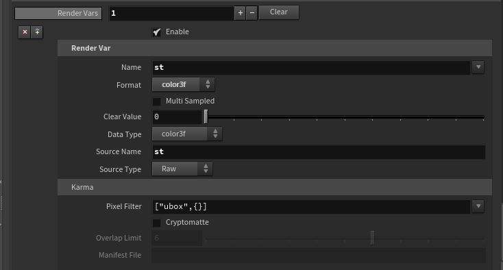

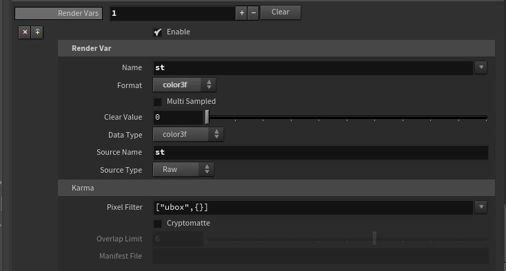

I'm having a difficult time figuring out what I'm doing wrong when I try to render UV passes in Karma. It's giving me a pattern for every face instead of the object. Any help would be appreciated!

Hi try this instead.. Best Mark

Thanks Mark! That worked once I changed the source type to Primvar.
