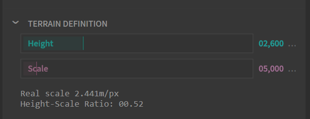

Eetu_Mainframe
Yeah the height scales are a bit tricky to maintain. I think it also depends on the settings on your input and output nodes in Gaea, but in my case I now need to divide with the height-scale ratio defined in "Terrain Definition". YMMV
I can't seem to find that Terrain Definition section in Gaea? Where is it located?
- smbell
- 75 posts
- Joined: Feb. 2017
smbellEetu_Mainframe
I found it. In case anyone else is as blind as me... It's all the way at the bottom of the Build Panel collapsed.

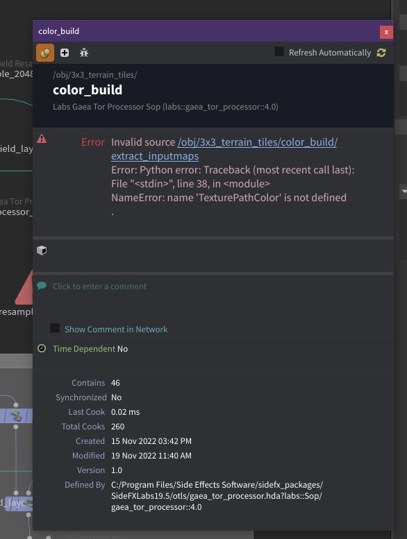

Has anyone been able to successfully output color information with the new labs node (19.5.416, from the github)?
As soon as I add in a color output to a working .tor file it just refuses to do anything, height or color. Just nothing. If I disable the color outputs exposed "colorOut" and rebuild, the height works fine.
If I enable the custom outputs, then I get a different error "TexturePathColor is not defined"
I don't really need it to show the color in the viewport, I just need it to output the files.

Eetu_Mainframe
Ugly workaround, but what if you split your color channels to three grayscale outputs with an RGBSplit node in Gaea, and then join them back into color in Houdini? :P
I somehow managed to get it to work, not sure what I did differently than the last 15 times I tried, but it's working. It still won't do the height and color at the same time directly into the nodes volume primitives (either or works fine), but it is outputing both height and color maps with the Custom checkbox enabled and that's all I need.
