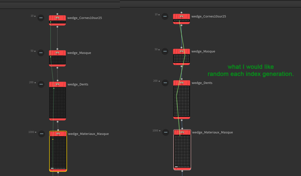

Hi Guys,
how to totaly random generation of several wedges?
PDG act like : 111 - 112 - 113 - 121 - 122 ...
What I would like : 213 - 132 - 312 - 233 ...
pic attached.
Thank you for help
wedge random

Hi Tamte,
I will explain what I want, perhaps I get the bad way to do it!
I have 5 differents faces,5 differents tooths, 5 differents materials, this gives me 125 combinations. I use wedgeindex to sort this all, but I would like to give randomness to my sorting because topnet gives me face1 + teeth 1 + material 1 then F1+T1+M2 then F1+T2+M3.. It miss randomnes for me

WowNemsthis doesn't explain why you want randomness in the order of your 125 workitems
- since if you want to compute all of them, then no matter in which order there will always be F1+T1+M1 among them
- if you don't need all of them you can always use Filter By Expression to filter just random amount of them to compute
- or is it because you simply want them to be generated in random order so that you have some random samples before the cooking is fully finished?
you can for example append Python Processor node at the end of your tree and do something like this in onGenerate
import random random.seed(10) items = upstream_items[:] random.shuffle(items) for i,item in enumerate(items): new_item = item_holder.addWorkItem(index=i, parent=item)
