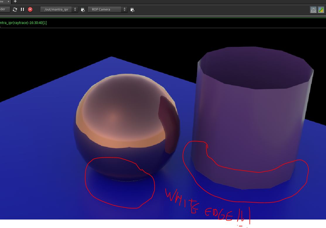

How can i remove this white edge in the Mantra render?
   2901   2   0
19 posts
Joined: Feb. 2019
Hello everyone, please i need your help i'm new in Mantra and when i render these objects, i was watching this odd white lines in the intersection and i want to get rid of this thing.
My settings
Sampling:
Light samples is 16
Pixel sample: 10,10
Min ray samples: 1
Max ray samples: 15
Diffuse quality: 3.58 i used a enviroment light
Reflection quality: 2.22
Noise level: 0.00655493
Limit:
Reflect Limit: 20
Diffuse limit: 1
Thanks for your help and greetings from Machu-Picchu - Peru
8380 posts
Joined: Sept. 2011
_udo_
Get rid of the intersection. Move the shapes apart so that they don't intersect.
6 posts
Joined: April 2008
I'm also getting these white lines. Even if I separate close proximity surfaces. I've tried switching karma cpu/gpu, material types, spec options, etc.
Narrowed it down to the dome light causing issues. I've swapped for a large overhead area light. But that's not always going to be a solution.
