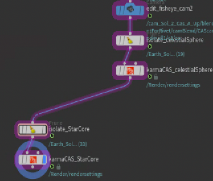

Ok, I think I got antc's suggestion working.
Please refer to attached screen grab and simplified hip file.
I use a Render Geometry Settings LOP to isolate the starBackground.
Then I append a karma LOP to render the starBackground.
In order to isolate the planet, I first have to hide all geometry with another Render Geometry Settings LOP.
Then I make the planet visible with anotherRender Geometry Settings LOP.
Then I append a karma lop to render the planet.
They appear to be doing what I want.
However, I want to be able to daisy chain the karma lops so I can submit both passes to our qube farm.
When I try to render the bottom karma lop, it doesn't render karma lops higher in the chain.
How do I mimic the behavior of linked Mantra Rops?
Thanks

To schedule render dependencies I think you'll need a ropnet or top network. If you dive into the karma lop you'll see that it's just a karmarenderproperties lop followed by a usdrender rop. So I would try and keep the configuration for each pass in it's own branch (for simplicity) and terminate each branch with a karmarenderproperties lop. In a ropnet you can then build the appropriate network of usdrender rops (one for each pass).

Like antc said, don't daisychain the karma nodes, they aren't rops. Each modifies settings of the node before it so you might get unpredictable results. For example, if the first karma node defines an aov, later karma nodes will still render that aov since it's on the stage.
I've attached a scene that uses context options to vary the visibility of objects on the stage with several usdrender nodes at the bottom of the tree.

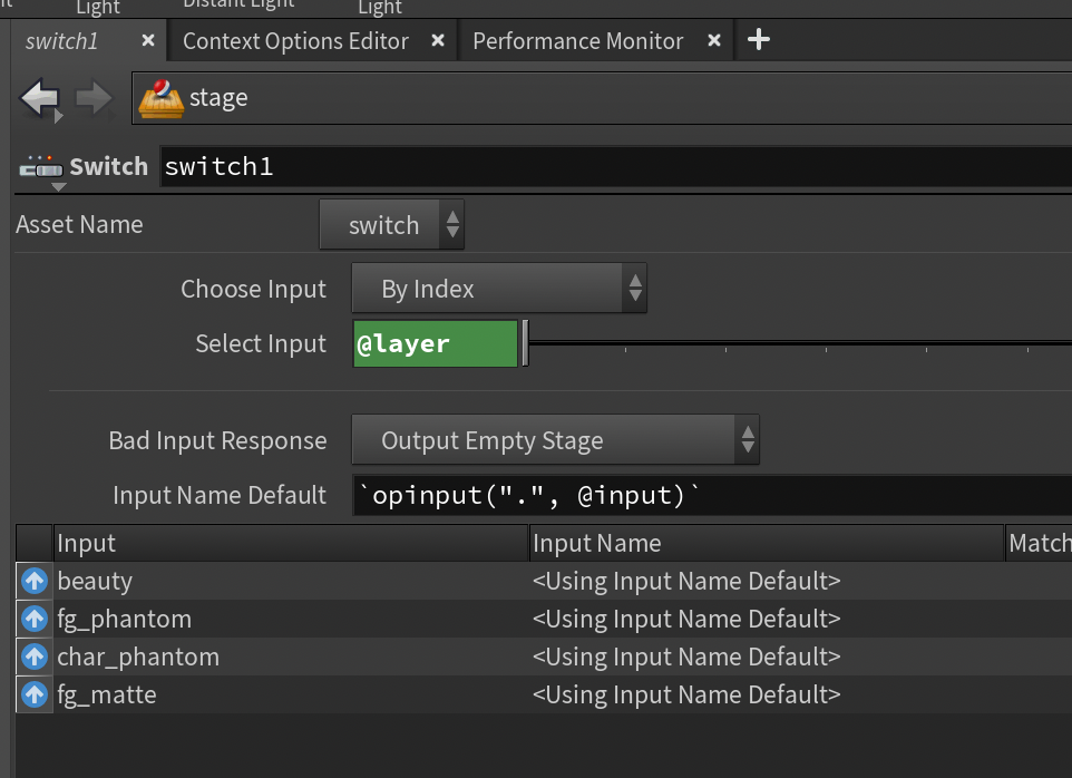

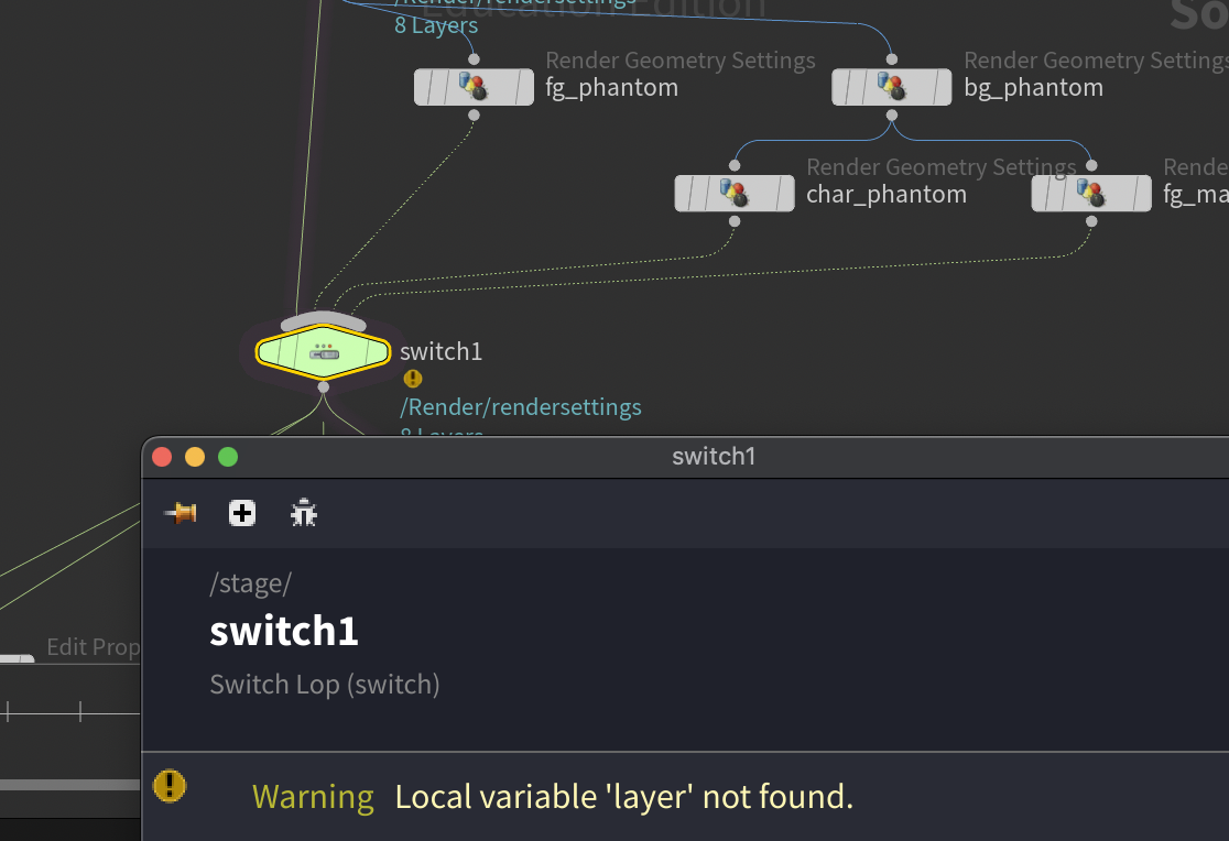

jsmack, you have a switch node that references a variable called @layer, but it's complaining that it can't find it.
Sorry if I'm overlooking it, but where is it defined?

jlapre
It's a context option, it's defined on the fly by the context. In this case the usdrender rop pushs the value onto the stack. You can see a context options parameter on usd and usdrender rops. There are also nodes specifically for setting context options.
