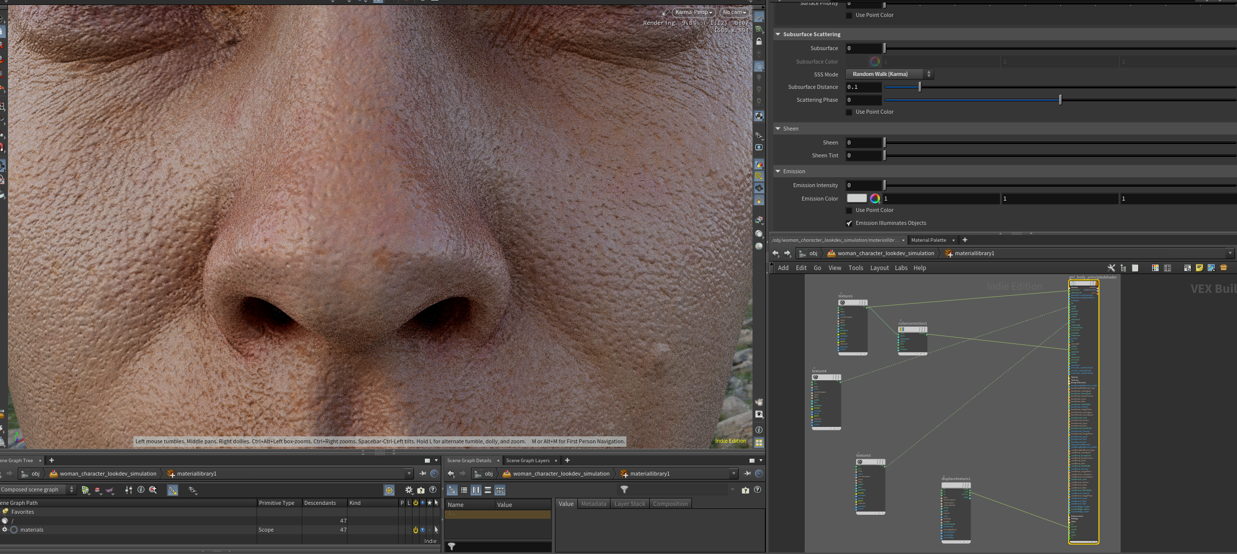

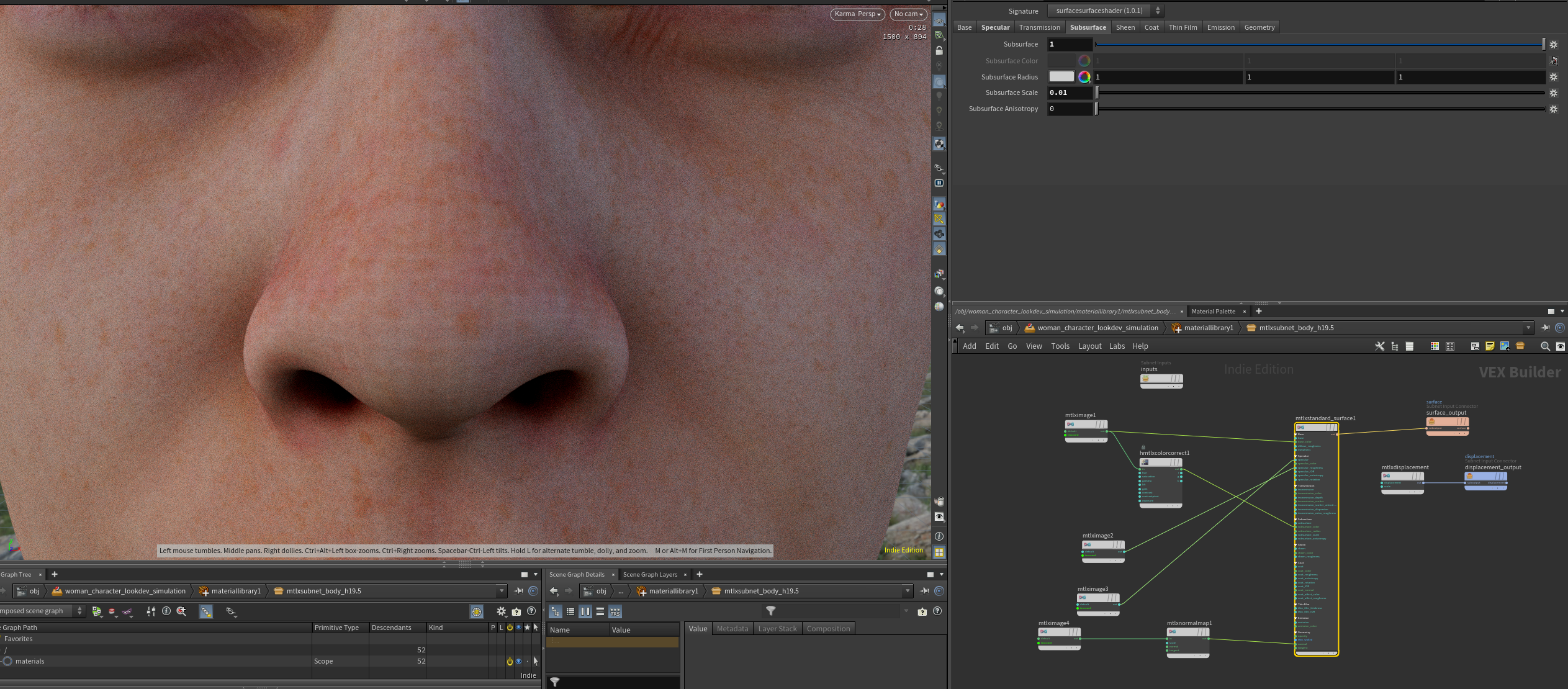

Is there a way to get normal maps to work with subsurface scattering using materialx? It only seems to work using the principledshader. And if so could I get it working with karma xpu? Thanks

Normal maps don't seem to be working at all with subsurface scattering using materialx standard surface material in Houdini 19.5.303. I thought I saw in the demo video for Houdini 19.5 a Capybara with subsurface and normal maps using mtlx in xpu. I cant get the normal maps to work with subsurface scattering at all using cpu or xpu.

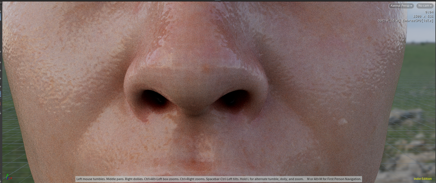

I see. So I just need to make the character more shiny for bump to show with subsurface scattering. I realized the path for my roughness map got broken so that's why the character wasn't shiny. I reconnected the texture and it seems to be working now as expected. Thank you!
Well atleast with Karma CPU. It looks a little strange with xpu?
I think it's probably texture resolution.
With XPU there is a global texture resolution clamp of 2048
You can change that via an environment variable
eg
export KARMA_XPU_MAX_TEXTURE_RES=8192
