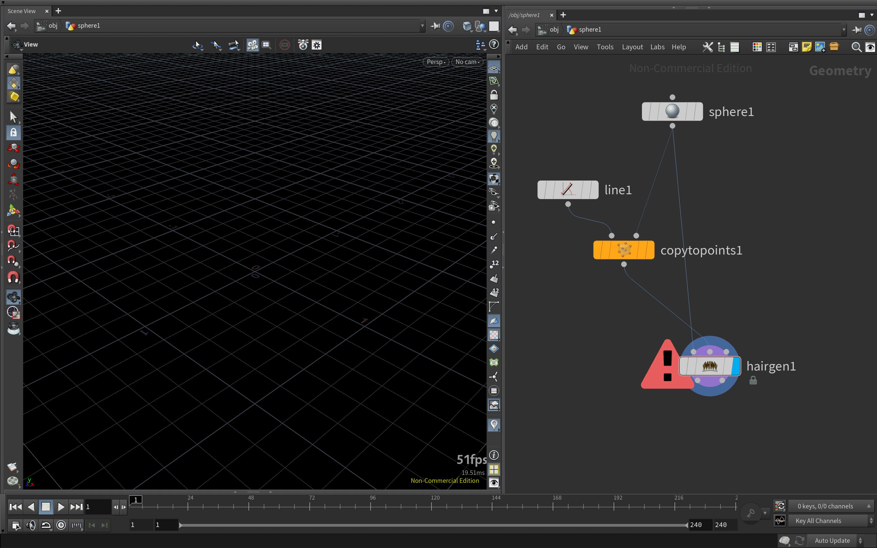

I am trying to generate hair from custom guides that I create inside Houdini and it gives me an error. I guess I should define these splines as guides in a way? Any thoughts?
Thanks!

If you click the warning message it says "skinprim attribute required on guides." So, you need to pop a Guide Skin Attribute Lookup in there:
14 posts
Joined: Dec. 2016
Perfect thanks!
