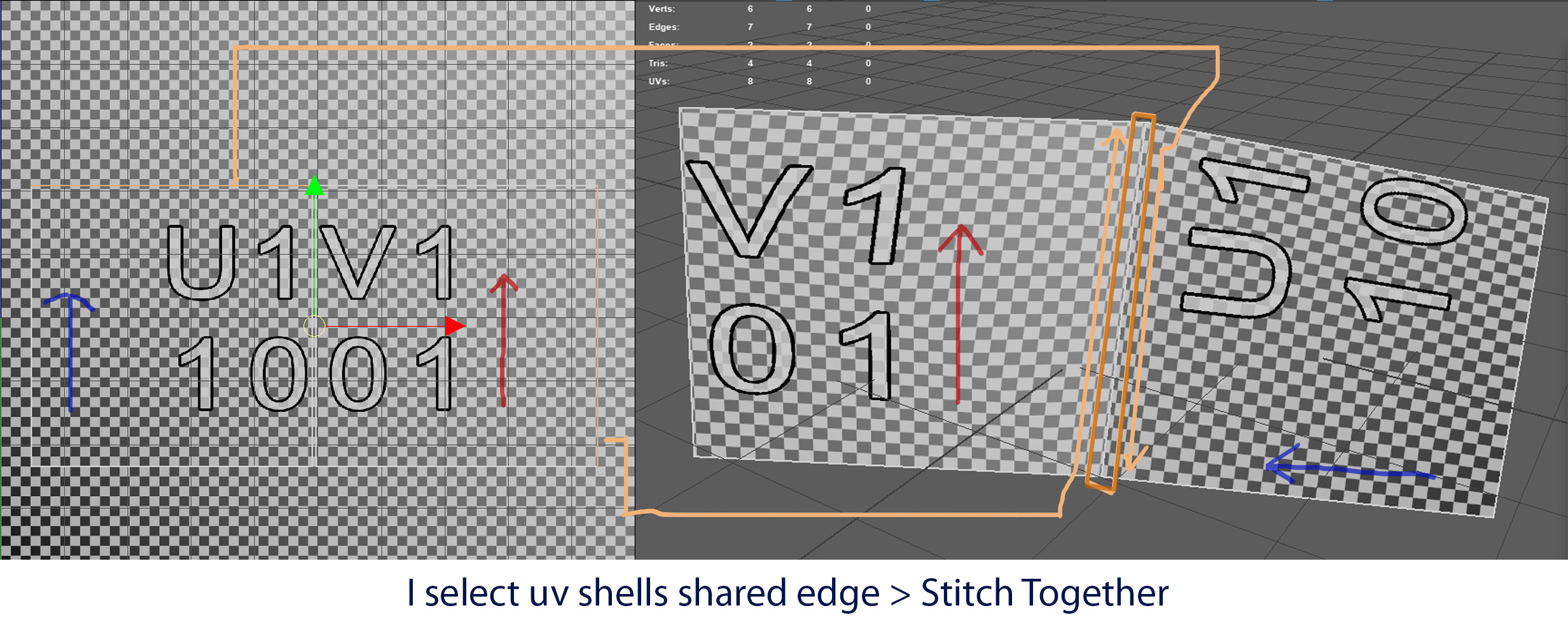

I want stitch uvs in Houdini like in Maya. When you select uv edge and select stitch, it will stitch with the shared edge with neighbour polygone and will rotate.
Is this workflow possible in Houdini?

Thanks for your responses. Maybe Its better to attach a hip file and illustrate me issue further. I want to rotate point/prims/uvs in uv editor/space.
Desired result.jpg (279.3 KB)
Rotate Uvs_issue.hip (344.0 KB)
