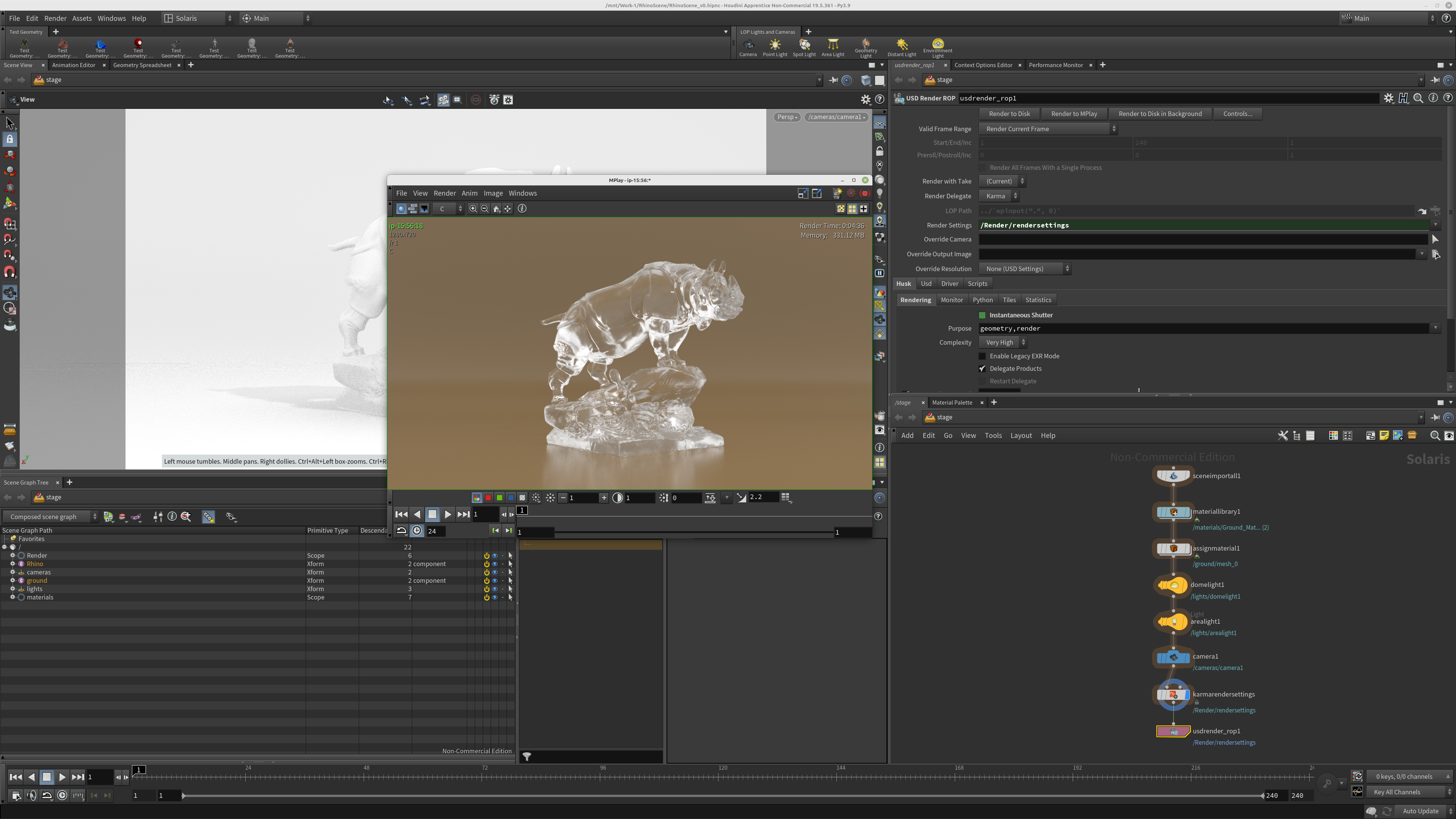

I have updated my rhino test scene for Houdini 19.5, link to the file below...
My results...
AMD 8 cores CPU + Nvidia GTX 1650 4 GB
Linux Mint 21 with Nvidia drivers 515.65.01: 11 minutes 06 seconds, memory used 330.76 MB
Windows 10 Workstation, Nvidia drivers 516.94: 15 minutes 34 seconds, memory used 1.22 GB
AMD 8 cores + Nvidia RTX 3060
Linux Mint 21 with Nvidia drivers 515.65.01: 4 minutes 36 seconds, memory used 331.12 MB
Windows 10 Workstation, Nvidia drivers 516.94: 5 minutes 02 seconds, memory used 1.33 GB
On Windows the RTX 3060 is about 3 times as fast as the GTX 1650, while on Linux it is about 2.4 times as fast, both Windows and Linux uses the latest Nvidia drivers, the memory usage is also quite different, no idea why.
I must say that I am a bit disappointed with my new RTX 3060, I was expecting it to be at least 4 times as fast as the GTX 1650 with XPU.
EDIT: I made some tests with Blender's Cycles and the RTX 3060 can be as much as 4.6 times faster than the GTX 1650, depending on settings, so my guess is that Houdini XPU will get better over time!

Are these times pre-warmed, or cold? I've noticed a 30-40 second spin up time for the Optix library regardless of scene complexity.
I ran your test on my system and got the times:
(tests were done a machine that wasn't exactly idle so they aren't that scientific)
2:57 (cold) 2.19GB Mem
2:26 (warm) 2.16GB Mem
Embree device: i9 10850K
Optix Device: RTX 3090

Is it the same on Linux? the 30-40 sec spin up?

I don't know, I don't have access to a linux system with hardware drivers that support XPU
