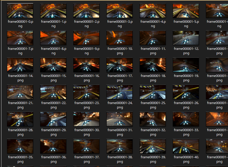

I created "convert_images" node according to this article.
https://www.sidefx.com/docs/houdini/tops/tutorial_pdgimagemanipulation.html [www.sidefx.com]
Since {inputfilename} expression has no more used, I used @filename attribute instead, but I got only 2 types of filename pattern ... not file names(frame000001.jpeg, frame000002.jpeg, ...) but directory names(brimstone_images, stock_pictures).
I also tried pythonscript node using below, still got same result.
file = work_item.attribValue("filename")
work_item.setStringAttrib("input_filename", file)
Now how can I get each work item name?

Sorry for the lack of explanation, I used expression in ImageMagick > Output > Output File Path, and got result above.
now I will use @pdg_input, and some method to split it.

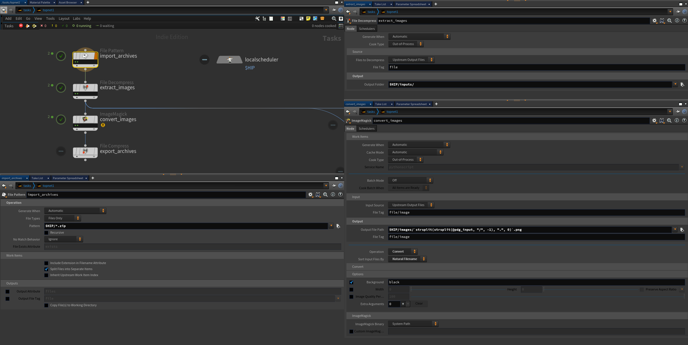

Can you post a screenshot of your work item information and TOPS graph? That would maybe clear up some things.

Here is whole capture.
I set each parameters just like this tutorial, and changed only OutputFilePath item.
Using @pdg_input instead of @filename, result changed a little but it is still incomplete.
also I tried each "Generate When" item "Automatic" to "Each Upstream Item is Cooked", got same result.

Reading the documentation for the imagemagick node (https://www.sidefx.com/docs/houdini/nodes/top/imagemagick.html [www.sidefx.com]) there seems to be an attribute called {inputfilepath} which you might be able to use. As you mentioned, the {inputfilename} seems to be gone. Alternatively, you can also use the @output_dirs attribute that should come from the file decompress node to point to a path and then use some globbing (for example *.png) to select all files and expand them to separate work items. You can then get the filename attribute correctly. For as far as I can read here, the instructions in the tutorial you are following do not accommodate for the removal of the {inputfilename} attribute, so I guess you have to dive a little deeper now By holding middle-mouse button on a work item you can easily inspect the attributes it holds and debug that way.
