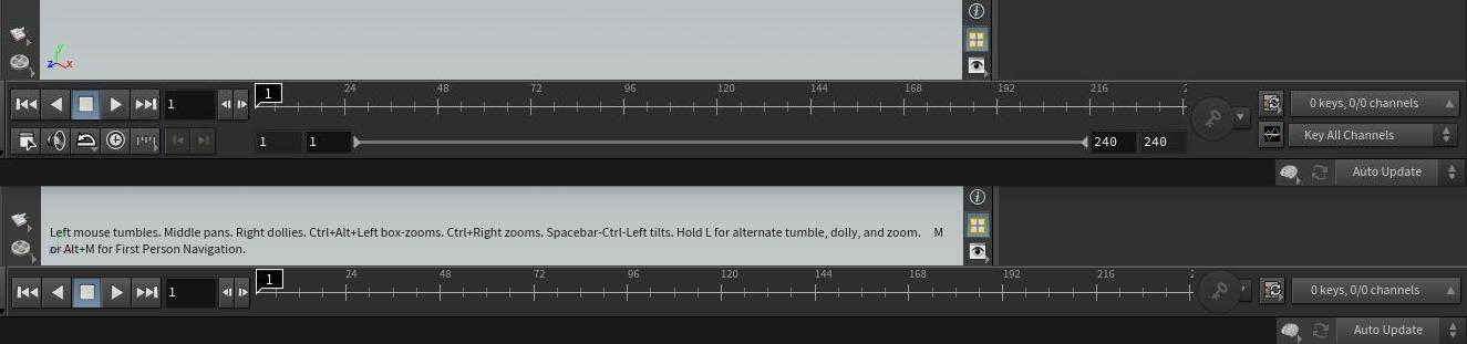

On a related note, is there a way to hide the playbar via Python? It's not in the pane list and I can't see to find anything obvious in the API. thanks!
Per SESI's comment this is not possible:
"I don't think we have any ability to hide the playbar at all, so there's nothing to add to HOM for this."
I filed an RFE for this #127072. So bump it up if you wanna see it in Houdini
94 posts
Joined: Aug. 2010
thanks for the heads up! best I could find so far is this one:
hou.playbar.showRangeSlider(0)
