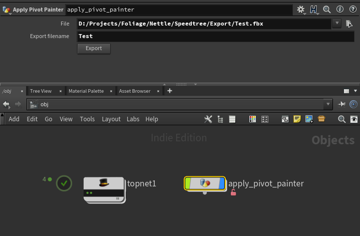

I'm using Unreal PivotPainter inside my custom HDA. "Export" button parameter of the Unreal PivotPainter node is exposed to the HDA so I can press button from HDA interface. It works fine.
Then I wanted to use TOP HDA Processor to apply PivotPainter to all FBX models in folder. Documentation says "Buttons are converted into toggles within the HDA Parameters tab. When a toggle is on, it means that the HDA Processor will press the button before cooking." but unfortunately button is not pressed.
Since Unreal PivotPainter's button using Python callback script, I also tried to create additional button param that just runs Python script
print("Test")
It also doesn't work. How can I get HDA Processor to run button's callback script?
Screenshot 2022-09-14 162111.png (42.5 KB)
Screenshot 2022-09-14 162331.png (75.4 KB)
