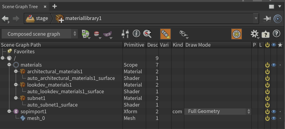

I like to save my material libraries as HDAs so they can be easily synchronized. But I can't get the Material Library to pick up my materials when they are inside an HDA, or even inside a subnet within the Material Library. Nothing inside a subnet gets the Solaris Material Flag, instead it's like an ordinary material network.
Is there a different workflow I might use to import these materials?

Late answer but if I found this post because I had the same issue, others will.
The issue is that there's no node with the export flag (orange one) on.
Easy fix.
