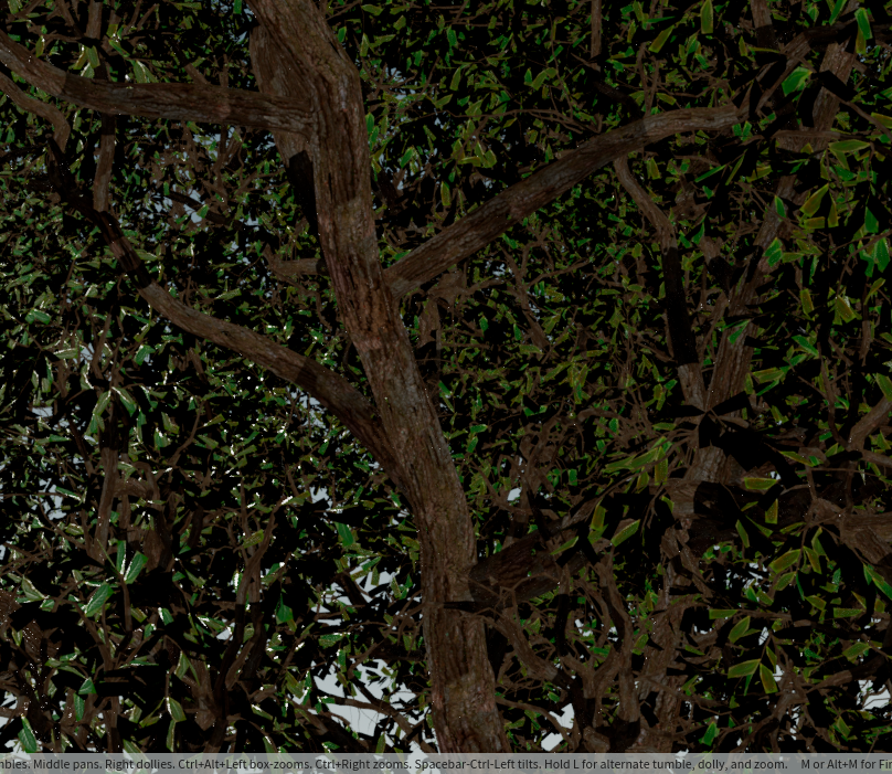

I am trying to render a speedtree as point instances on Karma but I am having issues with some textures rendering black and dark on XPU where in CPU it working correctly.
I know that XPU have some requirements about proportion and size which I made sure that at least the limit size is inside the limits but I am not sure about how proportion/size works.
Any tips?
Any tips?

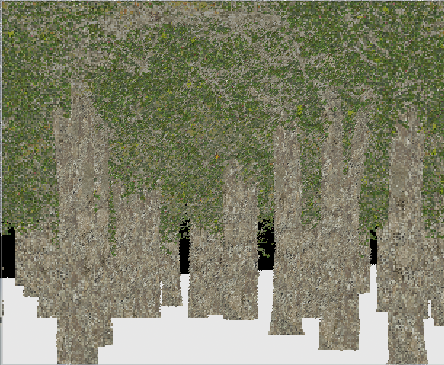

Here is another example also from speedtree and texture issues/differences between CPU top / XPU Bottom. I am using point instancing by the way with build 368.
It seems that in XPU the some textures are not mapped correctly mainly with the leaves but the color is there, maybe an uv issue?
