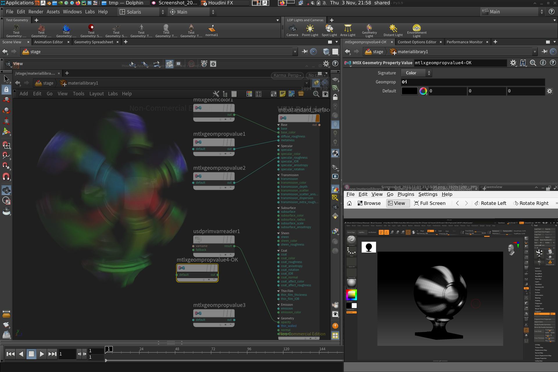

If you want point opacity, you can name the attribute Alpha. It will be automatically converted to displayOpacityprimvar and picked up by Principled shader. Attributes like metallicand roughwill also be automatically used. If not, you can try pulling them with "USD Prim Var Reader".
With MaterialX, you first need to pull geometry properties from USD primvars using "MtlX Geometry Property Value".

Edit2: To get an attribute was very easy with your network setup. USDprimvarreader and mtlxgeompropvalue both work fine. Here's an image for that.
