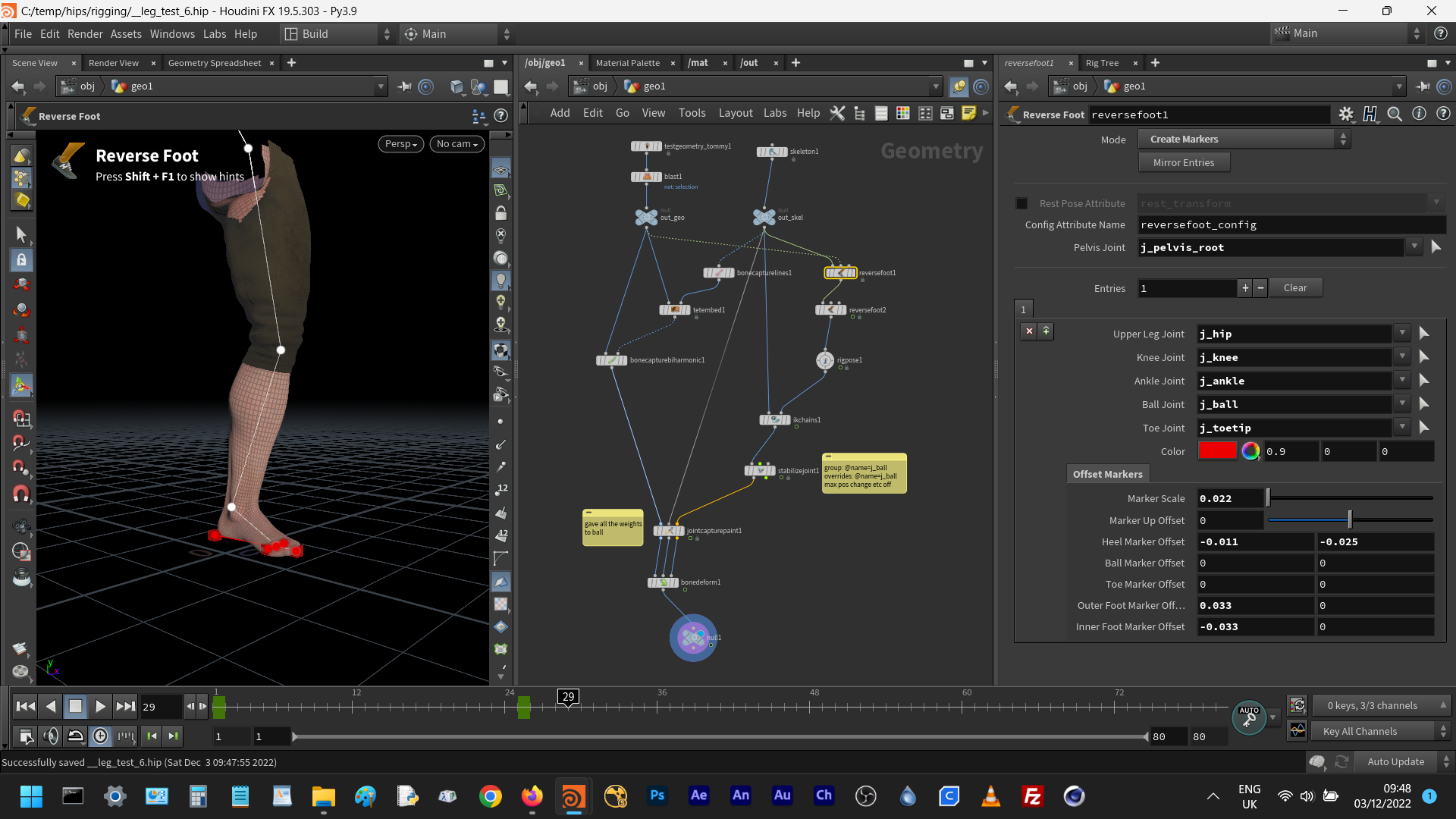

I managed to get a foot roll behaviour working using 'reverse foot' and 'stabilize joint', however there should be a way to do this without the need for the stabilize joint node...it seems once you add the IK chain, the toe joint ends up dipping into the ground, the behaviour without the IK is how it should work...any ideas?
I'm pretty sure a skeleton blend is needed somewhere, but I can't get it to work...

Yes I actually did that tutorial and ended up with the same problem lol...everything works great except for the ball roll, which means it's a small parenting problem somewhere..The toe and heel roll work fine and push the IK leg as expected, so it has to be a small issue....
Basically once the IK chain is added, the ball joint no longer respects being the child of the toe joint....

Hmm, did this with the reparenting node without the reversefoot node. The IK maybe should go only from hip to ankle, so it probably would not change any reversed parenting chain of the foot.
