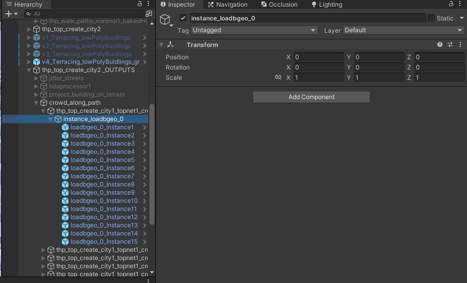

My next step is to scale it with the PDG but ran into some trouble. The same workflow with using the unity_script doesn t seem to work. The attribute is created but doesn t trigger the attaching of the unity script to the pdg output.

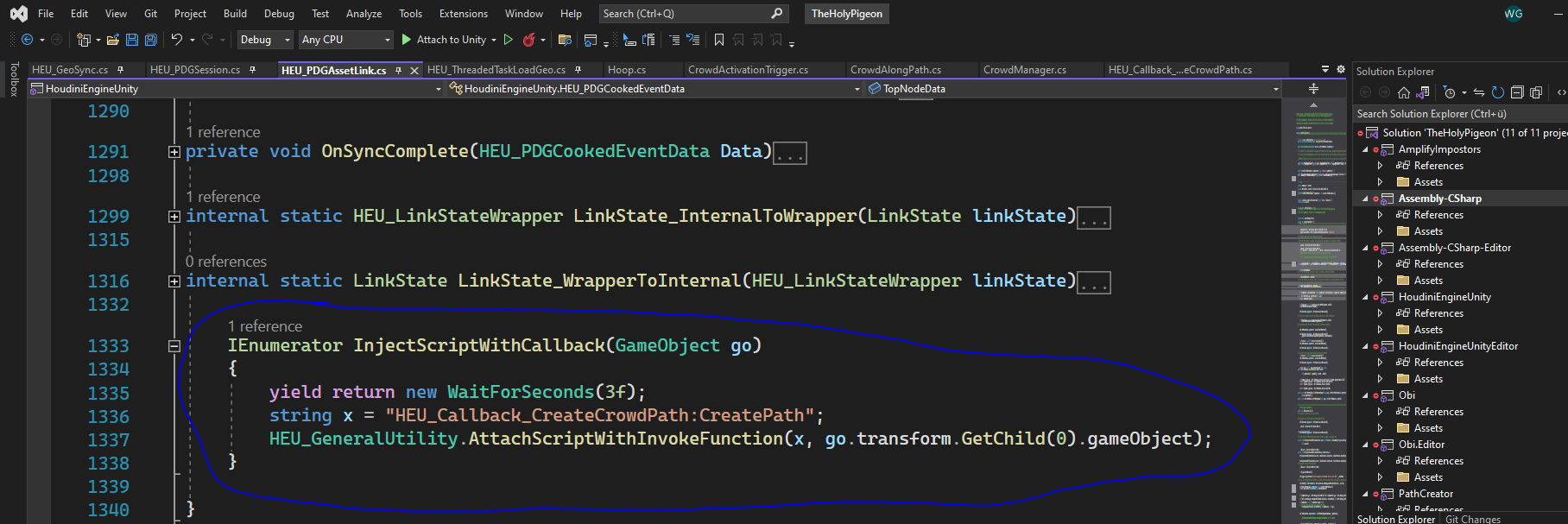

I found a hacky solution while digging deeper into the forums and found something i could use [www.sidefx.com]. With this i slightly modified the HEU_PDGAssetLink.cs to attach the script and invoke a function.
This solution is not particulary good since you have to manually define the string (YourScript:YourFunction) in the HEU_PDGAssetLink.cs file and triggered with a delay since i couldn t figure out when exactly the child gameobject is created where i needed to attach my script.
