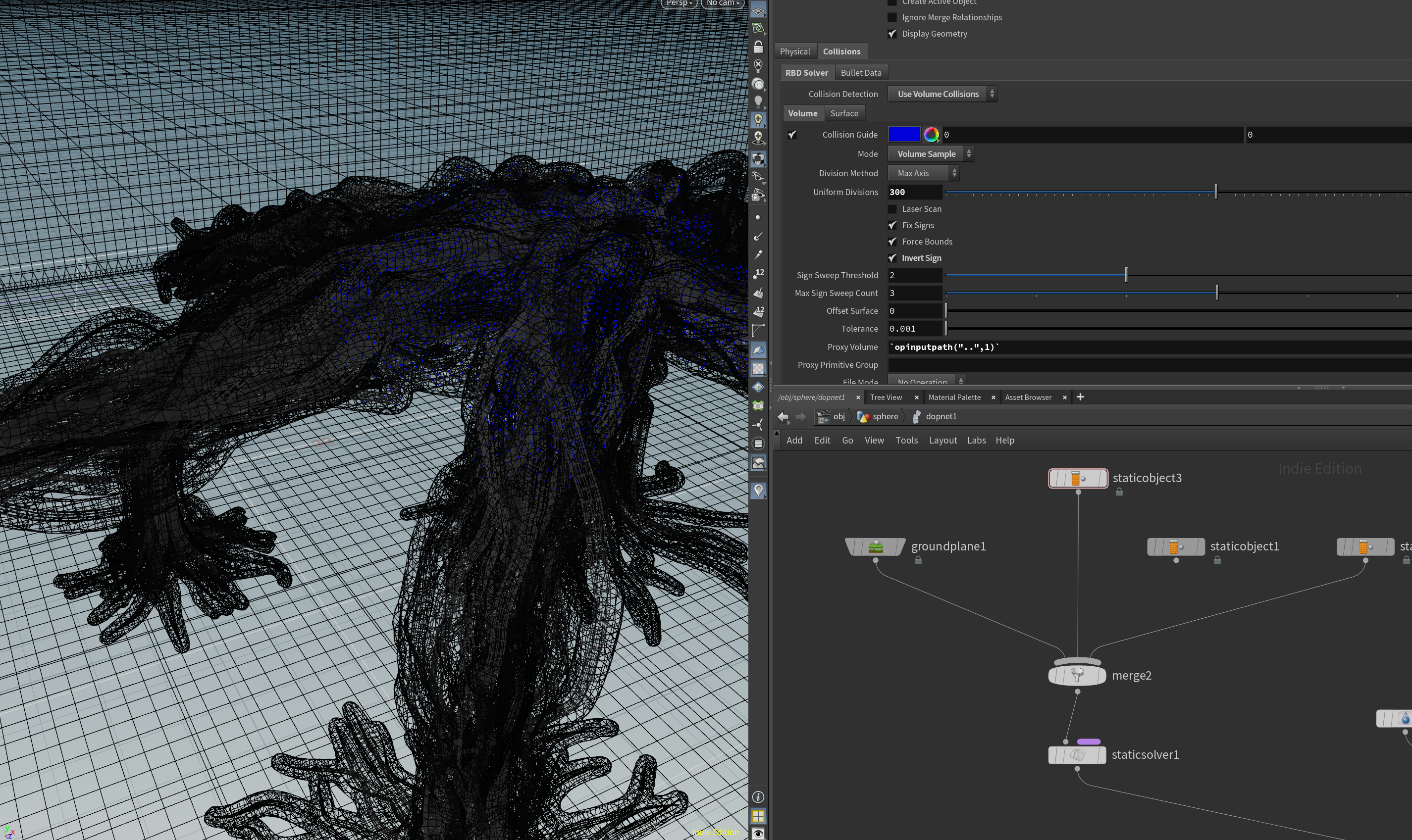

I have been trying to have fluid flow down the legs of this procedural walker:
https://www.youtube.com/watch?v=zH8F5CQerIE [www.youtube.com]
(One iteration was, using the Gas Target Force, as shown in this video:
https://www.youtube.com/watch?v=rs1Ig5bK0E8&t=1148s [www.youtube.com]
But since the Target is moving and deforming constantly, the liquid moving too hectically, and almost only situated at the legs in the back.
So I thought I would create a container around the walker, to stop the particles, from moving away from their target.
Walker geo -> VDB reshape SDF (dilate)
But I don't manage to create a collider, that contains the particles.
Can someone tell me how to set this up correctly?

Any ideas as to why the collision geometry might not contain the particles?
