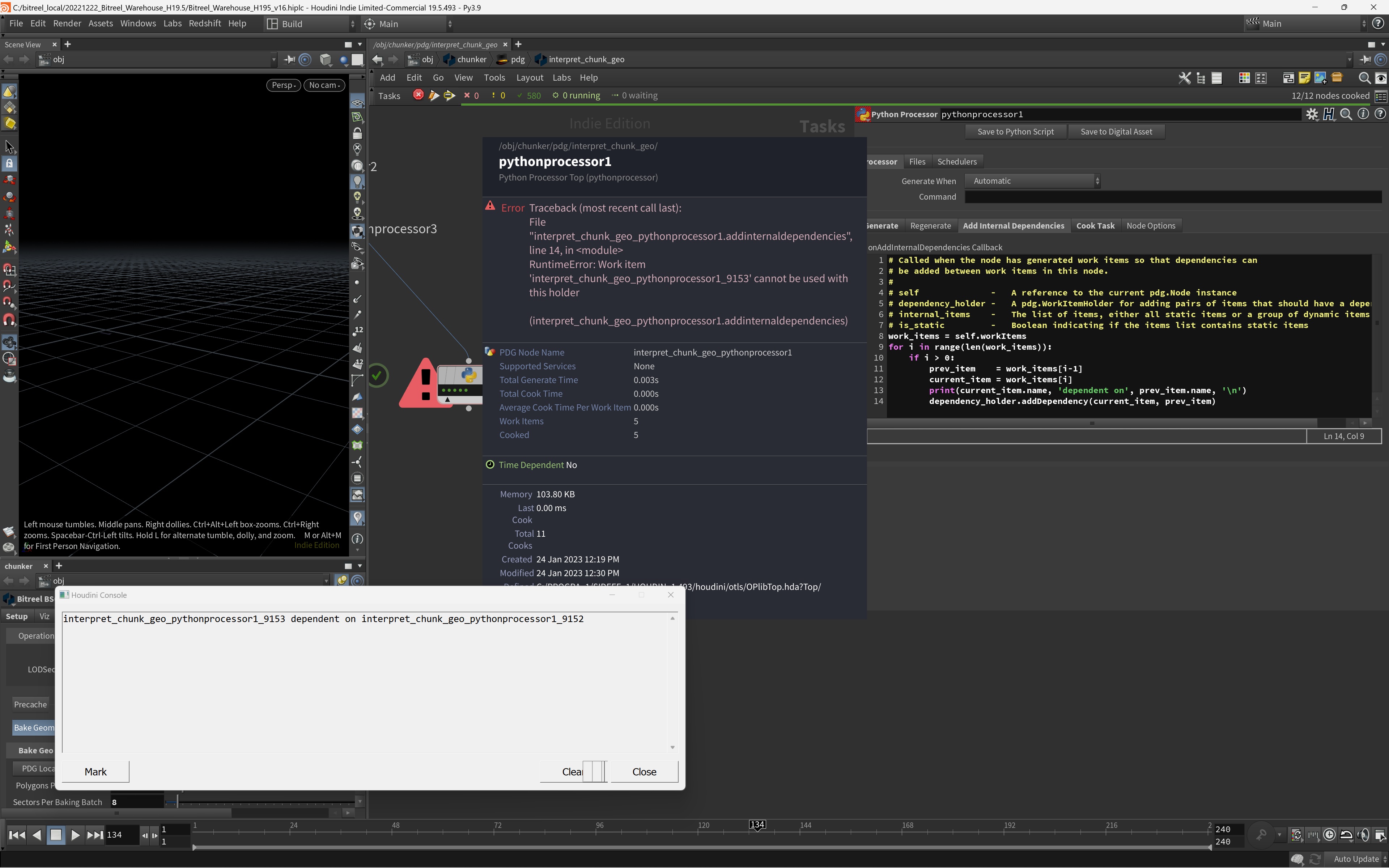

I'm struggling with figuring out how to get this working. Ideally, each of the tasks that this Python node would generate would simply wait for the previous one that was added before it to finish.
I tried putting this in the dependency, and getting this error. Where did I go wrong?

Node callbacks are only permitted to access the local variables passed into them. In this case, the callback is only allowed to add dependencies between the work items from internal_items list.
This is especially important if your node is dynamic. A dynamic node generates work items each time an input work item cooks, and it might be doing that in parallel. Therefore, the list of work items on the node itself may be incomplete at any point in time.
It's important to note that onAddDependencies is called each time the node generates work item, not once per node. For example if your node is dynamic and has 10 input itemss, onGenerate will be called 10 times (once for each cooked input work item). onAddDependencies will also be called 10 times as well, once for each of the lists of work items produced by the corresponding onGenerate call.
You will need to change your Generate When parameter to "All Upstream Items are Generated" or "All Upstream Items are Cooked" if you need to access all work items at the same time.

Thanks, that does make sense. But doesn't give me the solution I'm looking for.
For this dynamically generated node. I want to form an internal dependency so that each item is dependent on the last item that was added. Where would I add this code, in the "on generate" I take it? And how would this dependency holder be constructed?

In order to do that, you need the node generate all of it's work items in one go.
If you set "Generate When" to "All Upstream Items are Cooked", then your node will generate all its work items with a single onGenerate call, once all upstream work items are cooked. It will then invoke onAddInternalDependencies once as well, on the full list of generated work items, which will allow you to add the dependencies you need.
If your node only needs the inputs to be generated in order to create its work items, then you can use "All Upstream Items are Generated" instead. But you have to use one of those options to force the node to do it's generation/internal dependencies for the whole node at once.
