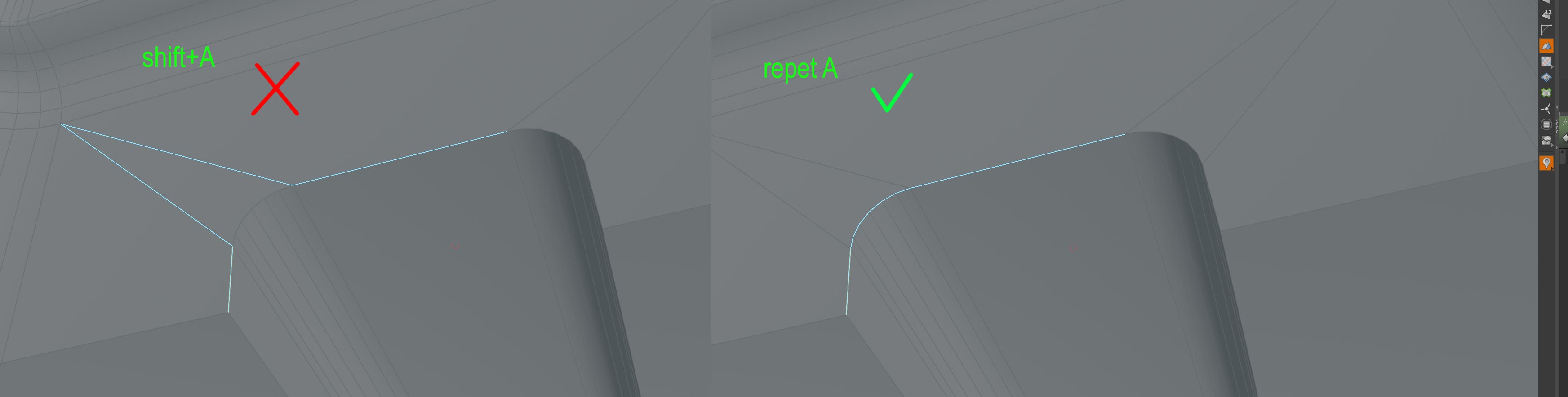

Good day.
I have a question for modelers, I have problems with selection of edges along a short path (shift + a). The short path algorithm is very poorly written. Please tell me what are the ways to solve the problem. Maybe someone knows a plugin that solves this problem?

I checked, the problem is still in the written algorithm. In other programs this function works much better and it's frustrating because Houdini is super powerful and I like its procedural structure.

Thanks, your method works great for edge sampling in splines, but I need a simple edge sampling along a shorter path for fast modeling.

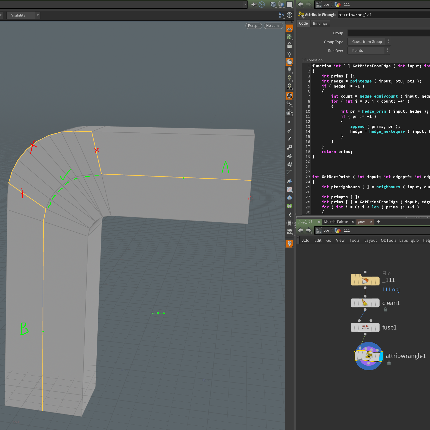

You can also select edge loops using VEX:

I don't understand how it works and how it can help me to quickly selection edges along the shortest path.
I did not think that such a familiar, already practiced to the point of automatism operation could put me in a stupor in such an advanced program. It's a bit weird and I haven't found a way around it yet, sometimes I have to select the edges one at a time. It is quite slow and unproductive.

There are a few things:
This code only selects edge loops using the connectivity of quad polygons.
The wrangle should be set to detail run over mode.
If the result is like in your screenshot, there is disconnected polygons in that region of your geometry.
So attaching the geo here would help to identify the issue.

This is very simple geometry. There are no disconnected polygons here. I noticed that the algorithm only needs quad polygons to work correctly. I noticed that the shortest path goes to the place with the triangle, it chooses the path where the quad polygon is.
Test geometry 111.obj (2.8 KB)

I just tried your geometry, selecting the edge loops works as expected. Make sure to set the Run Over parameter to Detail.

Find Shortest Path also works in my test:

I found a way to correctly work the tool (True Path), you need to re-press the key (A). It's a pity that such a large community didn't know this.
Problem solved.
Thank you all for your help.
