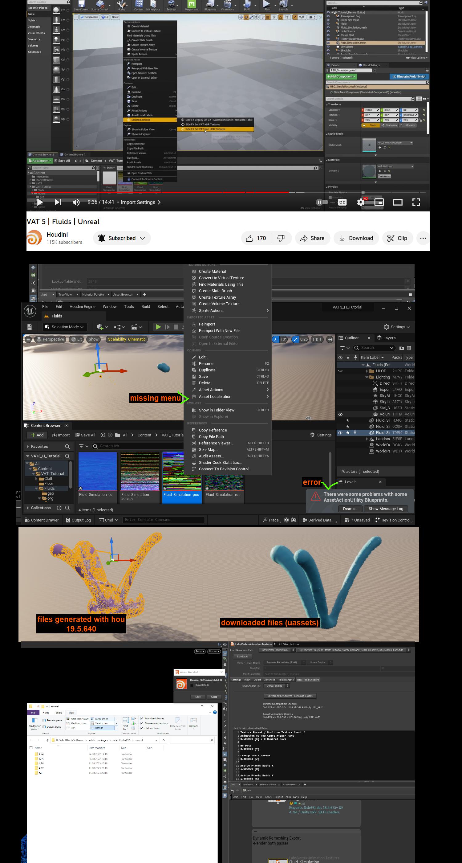

I have Houdini 19.5698, and I only see 5.0 folder in the Labs folder.
I's not giving me errors but the tools aren't displaying my VAT correctly.
7 posts
Joined: June 2015
I have watch all the tutorials regarding VAT, and did the process million times and my mesh is still not looking right.

Hi there,
we are experiencing the same issues like Mahmoud:
While working through the fantastic VAT series by Simon Verstraete, we were able to produce everything in Unreal 5.2 (with Houdini 19.5.640 and the SideFxLabs19.5/unreal/5.0-package) up until the fluids section.
While we are not seeing the Scripted Actions provided with the SideFx-Labs-PlugIn inside UE that Simon is using in its videos, we were able to set the texture settings manually so far. This is what we are looking at so far:
