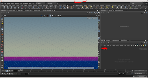

Scene view --> weird gradient issue
   2178   4   1
Joined: Jan. 2020
I see a gradient only in the scene view. Has anyone see this before?
Houdini 19
2184 posts
Joined: Sept. 2015
Just create a new window, change tabs, etc.
Viewport can be wonky at times.
5334 posts
It's due to the OpenColorIO view that you're using. If you're using 19.5 or higher, it should properly correct the background gradient.
Joined: Jan. 2020
Tried with 19.5, it's still the same
176 posts
Joined: June 2016
Looks like this is the reason for sure. As malexander said.
Just set that to default, this will get fixed
