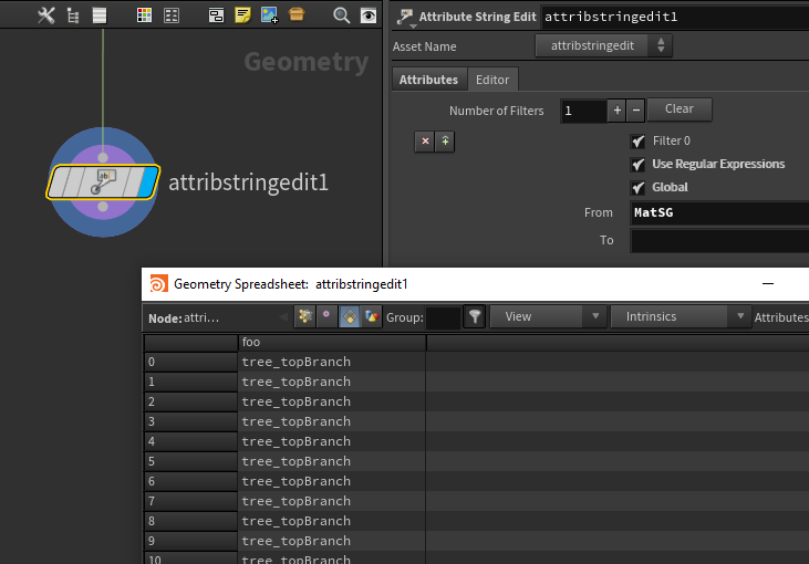

1857 posts
Joined: May 2006
The other way is with the attribute string edit sop:
